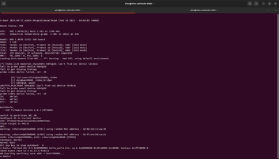

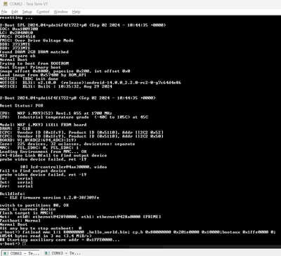

We are about to port our starter kits to the latest SDK (25.03.00). As the very first step we try to get simple hello world demo running. We are facing two problems:
  1. Starting demo from U-Boot using `bootaux`:  binary can be loaded and started. Feedback is that M33 is running. No output from Debug-UART

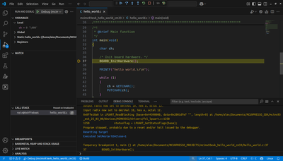

  2. Starting demo from debugger (J-Link v8.32) while Cortex-A55 is running (U-Boot):  debugger is not able to connect to M33:
Device "MIMX9351_M33" selected.
Connecting to target via JTAG
ConfigTargetSettings() start
ConfigTargetSettings() end - Took 30us
InitTarget() start
InitTarget() end - Took 7.74ms
TotalIRLen = 4, IRPrint = 0x01
JTAG chain detection found 1 devices:
#0 Id: 0x0892801D, IRLen: 04, JTAG-DP
Failed to power up DAP
Connect failed. Resetting via Reset pin and trying again.
ConfigTargetSettings() end - Took 26us
InitTarget() start
DAP: Could not power-up system power domain.
InitTarget() end - Took 13.2ms
Error occurred: Could not connect to the target device.
(The JTAG works, when setting the board to LP Boot via Serial Downloader we are able to start the GDB server and debug the hello world demo)

Running the hello world demo from current SDK (25.03.00) with bootaux from U-Boot is possible with older BSP based on:
u-boot-imx v2023.04 / older atf-imx 2.10 / ELE firmware version 1.1.0-17eafba6

so we found the issue for M33 not booting with newer versions. Wenn extending the board support for i.MX91 we lost M33 initialisation in SPL. Thank you for supporting

JLink Firmware is up to date. Debugging under Linux not possible.
OS: Ubuntu 2024.04
SEGGER: V8.32
SDK: 25.03 from github
Expectation: programm can be loaded / started / debugged with gdb / jlink gdbserver
Issue: gdb connects and loads to target, running / debugging not stable.
With Ubuntu 2022.04 / SEGGER J-Link V7.62c with NXP Patch debugging is possible

Chavira
Hi @Niebel-TQ!
I am tried again by my side in the evk board and the problem is not happening.
I am using ubuntu 22.04 and SDK 25 with the latest BSP version (6.12)
Best Regards!
