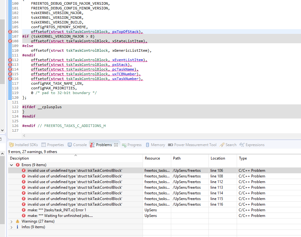

Hello, i have to debug a freeRTOS with my LinkServer.
I have follow th guide http://www.nxp.com/docs/en/quick-reference-guide/MCUXpresso_IDE_FreeRTOS_Debug_Guide.pdf  at point 2 but i have a problem when i set the
configINCLUDE_FREERTOS_TASK_C_ADDITIONS_H to 1
in the file freertos_tasks_c_additions.h i have

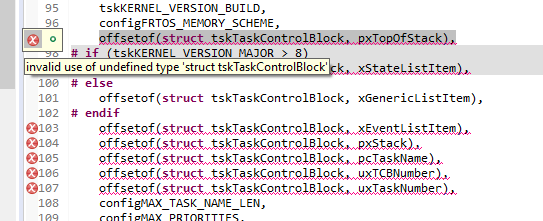

but an error is present
the struct is defined in task.c....
how to solve this problem?

These error markers come from the Eclipse internal source file parser. The reasons for these errors is because you have that header file open, but that file is used in a very special way: it is included at the end of the RTOS tasks.c file.
Just in that header file, not all data structures are present/visible/included, and the Eclipse parser flags this as an error. That would be correct for a normal header file. But as this file is included in a special way, you simply can ignore these error markers. The file will compile just fine.

Ok but how i can ignore these error? there is some setting in eclipse? The compiled file is not generated now
