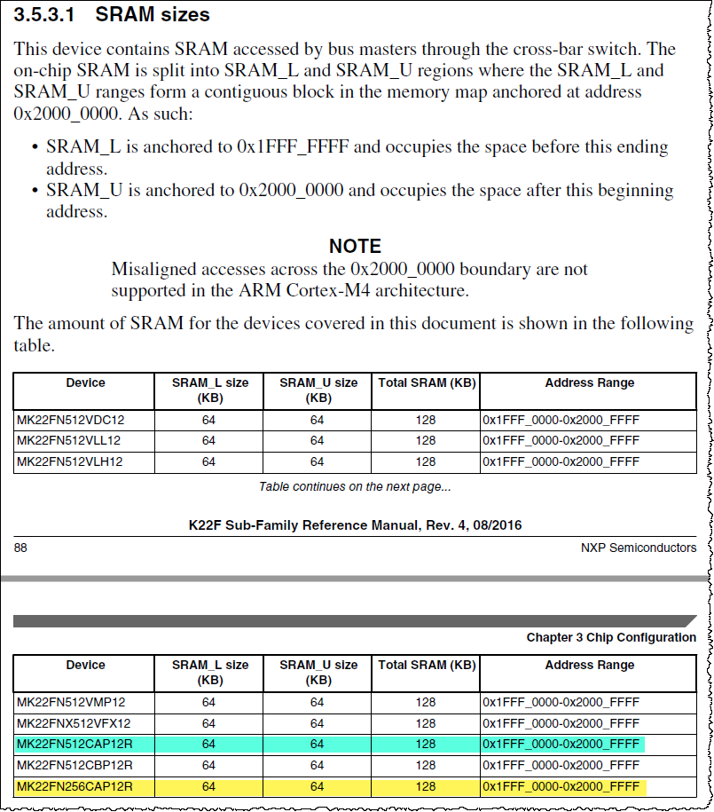

I need to create a project for MK22FN256CAP12 microcontroller. I'm using MCUXpresso v11.1.1, and have downloaded SDK_2_4_1_MK22FN256xxx12. However, when i'm creating a project using these sdk version, this microcontroller option does not appear in the Device Package field. What is the correct SDK for MK22FN256CAP12 microcontroller?

Please download the SDK_2.12.0_MK22FN512xxx12.
Select MK22FN512CAP12 when chose Device Packages, manually change the size of Flash to 0x40000.
Device Packages MK22FN256CAP12.pngMemory Configuration.pngFlash Memory Sizes.pngSRAM sizes.png
