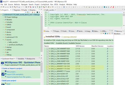

When updating a MIMXRT1176xxxx project from sdk 2.10.5 mcuxpresso version 11.1.1 to
sdk 2.11.0 and IDE 11.15.0
the flags at the beginning of "other flags" field are deleted/overwritten.
The compile line now attempts to run the linker because the "-c" is removed.
A workaround is simply to copy over the missing flags.

Yes, I used SDK2.11 and IDE 11.15.0 (required by sdk2.11) to try to update the project.That's where the failure happens. If you compile the project under IDE 11.15.0 without updating the components from the new SDK, it compiles correctly.
I thought I uploaded the project so your team could try the update process but I don't see it above? As a note, the project was supplied as a demo by Avnet in support of their MaaxRT board design which is based on the EVKMIMXrt1170 EVK. I have permission to supply it to you. I did not personally write this code.
I started the process of trying a fresh project and importing the code but that didn't go well.

    If you just import the SDK2.11.0 demo, no issues, right?
   And, if you use your customer demo, which update the SDK to the newest one, then you meet issues, right?
  If this situation, I suggest you use the SDK2.11.0 demo as the base, then add your customer code again to the new SDK project, whether this method still have issues or not?
  I import one new project with SDK2.11.0 with MCUXPRESSO 11.5.0, no compilies issues.
So, you need to check your installed SDK, do you update the SDK to the newest version?
 About your suggest, it is determined by our SDK team plan of the detail component version.
 The driver normally just add the related fsl_xxx.c/.h, to the pinmux, you need to use the periperal tool to add it, or add the code in the pinmux.c directly.
 Or you can copy the related demo pinmux.c to your own project.
