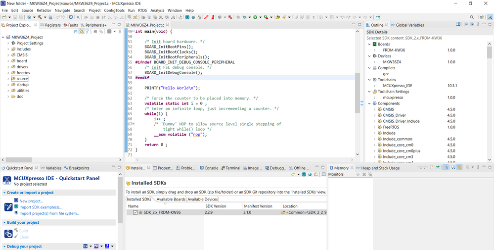

I am new to MCUXpresso SDK and trying to bring a Bluetooth characteristics on FRDM-KW36.
As per tutorial i have downloaded SDK v2.2.9 from https://mcuxpresso.nxp.com/en/dashboard?uvid=402984&to_vault=true# .
I was taken heart rate sensor example and was trying to import that example using MCUEXPRESSO.
And the folder structure is as below
I was able to compile this and this is working as intended.

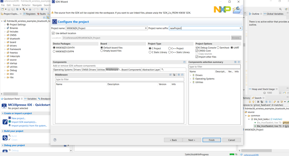

But when i am creating a new project, i am not able to select a middleware, as you see
Middleware and the packages i am looking for here is missing(Bluetooth related).
Am i missing any steps? Should I import all the middleware manually?
Please guide me some reference here.

Hi Nithin,

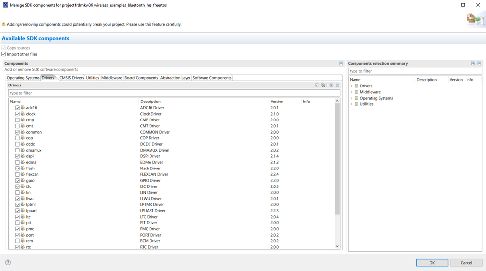

Hope you are doing well. You can add the Bluetooth folders manually, but if you want to create a project with BLE, the recommendations it to take as a base one of the BLE examples, do your modifications and add other drivers if needed.
