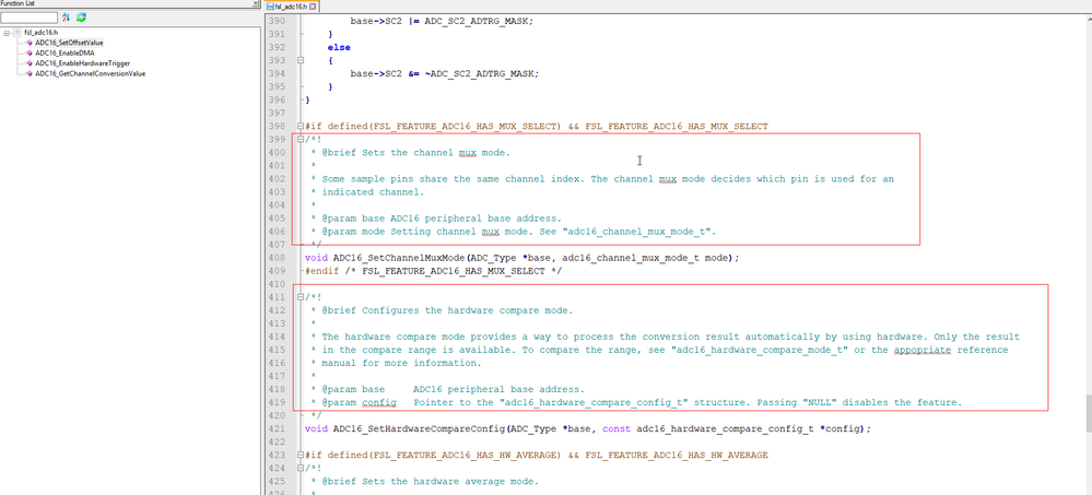

API documentation for drivers in MCUXpresso SDK - where is it located?

With MCUXPresso IDE 10.2 (see as well Overview of MCUXpresso IDE v10.2.0 | MCU on Eclipse ) you have direct access to the API documentation and more if you click on the SDK installed, for example the SDK API Reference manual:

Hello Russell Everett,
About the new MCUXpresso SDK package ,  API description is in driver header files,
for example driver ADC , find header file under SDK package : SDK_2.3.1_FRDM-K82F\devices\MK82F25615\drivers\fsl_adc16.h
Hope it helps
