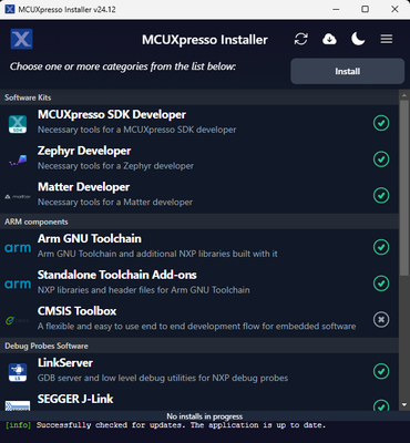

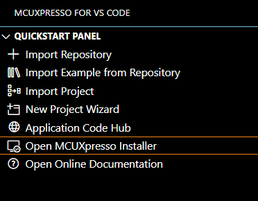

Advanced users can manually install the tools that are needed. Others can take advantage of the MCUXpresso Installer, which will automatically check for missing tools and install (or update) if needed. To open the MCUXpresso Installer, open the MCUXpresso for VS Code and then select 'Open MCUXpresso Installer'.
A new window will open up, select at least 'MCUXpresso SDK Developer', but you may select other options for your environment.

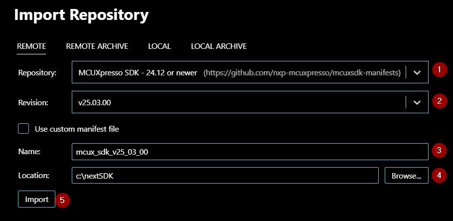

Once you have the environment set up, you can select 'Import Repository' from the quick start panel. Choose Remote and then select the repository from the drop-down list, here you should find the new GitHub SDK 25.03.00 or newer.
1. Select the repository to import
2. Select the revision or branch to import
3. The name of the repository is filled in automatically
4. Choose a folder in your system to download it
5. Select Import
Once imported it will enumerate under 'Imported Repositories'

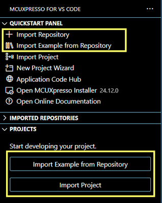

Importing an example
When your workspace is completely empty you will see that under 'Projects' there will be two options to import an example. If your workspace is not empty, then use the QuickStart panel to import an example.
For this guide, we'll import an example from the repository.
  1. Select the folder in which your repository is located.
  2. Select the toolchain
  3. Select the development board you are working with.
  4. Choose a supported example from the drop-down menu
  5.  For version 25.03.00, app type supports repository and freestanding versions.
  6. If choosing a freestanding application, then choose the location of where the project should be stored.
  7. Import

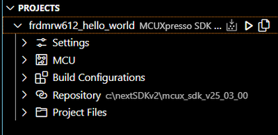

Exploring the project files
Once the project has been imported you will find the following sub-sections in the project explorer window.
Settings -  Includes several JSON files containing several necessary configurations for the project and tools.
MCU - Description of the board, device and package used.
Build Configurations - Contains the different build profiles generated that can be used by default. Generally this is the debug and release profiles.
Repository - Includes the repository contents, such as all examples, drivers and middleware.
Project Files - Includes the specific files for the project.

A freestanding example allows you to store the project wherever you like, offering greater flexibility. However, the files within the repository folder  within the project itself are shared among multiple examples. This means that any changes made to one example will affect other examples that use the same files, such as drivers and middleware.
Project Files
The project files as described contain the specific files needed in this example. For the purpose of this guide, hello world was imported to demonstrate the key file locations. Browsing the main content in the drop-down menu from the project files we can see the following:
Generally the files seen here are specific to the project itself. Changes to these will not affect other projects. Project files will generally include source, pin, clock and board files.
