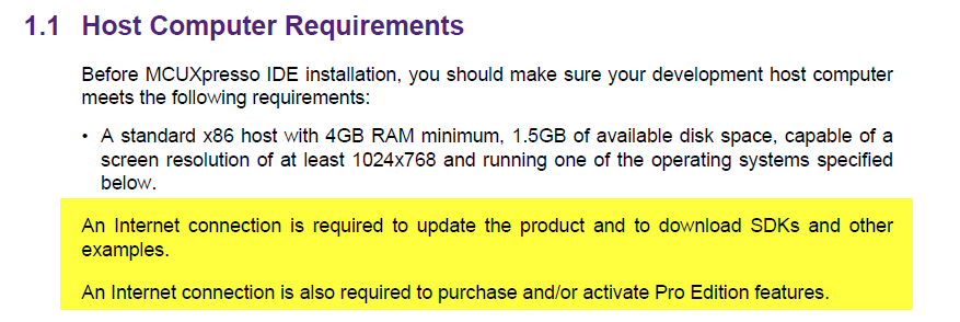

After several weeks of trying a lot of solutions, I found-out that the IDE needs Internet connectivity to define the MKV46,
I installed the IDE on another computer which has Internet connection, and it works.
On the off-line computer I got messages that no MPU selected. (although I installed the SDK for the MKV46, pins and clock files). On the online computer it works good.
Is there a way to work off-line?
2,637 Views
ZhangJennie
Hi Ben,
There is no absolute offline versions. If we need update the IDE or download SDK or purchase/active Pro edition features, an internet connection is necessary.
This is mentioned in MCUXpresso_IDE_Installation_Guide.pdf under the MCUXpresso install folder:
