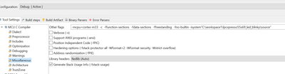

how to enter -isystem header paths in mcuxpresso

MCUXpresso IDE compiler has -I (include paths), -include(include files). Linker has -l (include libs), -L(include search path). This is sufficient to find system files. Could you please let me know why you need -isystem?
Seems MCUXpresso IDE doesn't arrange a place for -isystem .  If you insist adding it, you can add it in other flag:

please add support for this, would like to distinguish between third party libraries and our source code so that clang-tidy knows which files to suppress errors for.

well, GCC will not generate warnings from libraries we can use -isystem option. I will try option suggested
