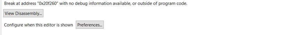

i am using MIMXRT1050DVL5B EVK board and also MIMXRT1052CVJ5B custom board. and trying to load the code to flash for both device's. but i am getting the bellow in console
"Executed Set Restart On Close=0
[ MCUXpresso Semi hosting Telnet console for 'atvs_evk1050_project J Link Debug' started on port 57645 @ 127.0.0.1]
SEGGER J-Link GDB Server V7.60b - Terminal output channel"
and downloading will terminated with shows memory address [attached the image].
please help me fix this.

jingpan
Hi @vinyas ,
On EVKB, default flash is the hyperflash. So, if you didn't modify hardware connection, please use hyperflash algorithm.
If you have modify hardware, please check if you have switch to "internal boot mode".
The address 0x20f260 is for ROM bootloader. That means the mcu doesn't jump to your application code. If above two point is not the case, please check your application's IVT according to section 9.7.1 in reference manual and AN12108/AN12107.
Jing
