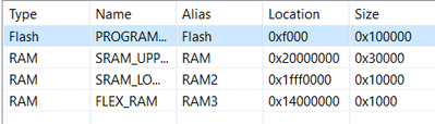

We are using the MK64FN1M microcontroller and we are trying to have the ability to flash two versions of the same app , remotely, into the program memory. The ideia is to prevent the device to be stuck if the flashing process goes wrong on one part of the memory having always the other half with an older version.
We are using an ethernet bootloader and we already can flash both parts of the memory and run the app from one or the other, but never having them both on memory or having the ability to switch from one to the other, or reflash them.
We must be doing something wrong on the memory partition , but I cant figure out what. Here is our partition :
Block 1
with SCB->VTOR = 0xF000 and when flashing, at the bootloader, the erase goes from 0xf000 to 0x7A000 and the start address is 0xF1D5;

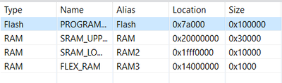

Block 2
with SCB->VTOR = 0x7A000 and when flashing, at the bootloader, the erase goes from 0x7A000 to 0xF4240 and the start address is 0x7A1D5;

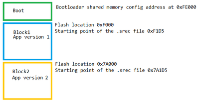

joao_ribeiro
Hi @jingpan ,
Thank you for the help and concern.
I am sorry if I was a bit confusing on my last post. With this image I intend to clarify the idea that I have for the memory
So I can jump from block 1 and block 2 having app 1 and app 2 running well, so the bootloader can point to 0xF1D5 and also to 0x7A1D5 without any issue. Although when I try to change the bootloader's configuration that is in the 0xFE000 address I can only have success if I am running the block1 and not the block2. As if the app in block 2 could not reach the memory at the address 0xFE000.
Using a flash tool could be a good way to find more about the issue, you are right. Can we recover the entire memory with the MCUXpresso IDE?
