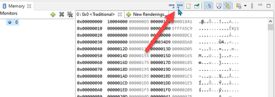

>>Using a flash tool could be a good way to find more about the issue, you are right. Can we recover the entire memory with the MCUXpresso IDE?
do you mean storing the memory in a file or something like that?
You can do that with the MCUXpresso IDE: there is an export functionality here:
Or see https://mcuoneclipse.com/2012/05/04/dump-my-device-memory/
Other than that, the IDE comes with the SEGGER/J-Link tool. So if you use the SEGGER firmware with your board, than you can use the J-Flash lite to dump the memory too.
