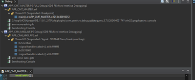

we're currently  working on a project using a custom  iMX RT1176 (CM7 master / CM4/ slave)  with the memory map attached below , the issue is when building for release we face no problem , but when we try to run a debugging session , the CM7 loads fine but the slave core wouldn't it through a hardfault
we're not sure wether it's an memory mismatch or a debugger problem or one might suspect a flashing algorithm  issue via PEmicro Multilink for   flash programming

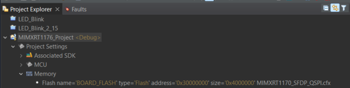

Go to project explorer and select project, now go to project setting and select memory and right click on memory and edit it. and in that select flash driver. Screenshot 2024-07-04 144614.pngScreenshot 2024-07-04 144614.png

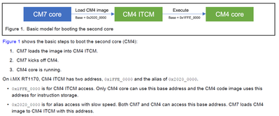

Thanks for the update , althought i want to believe it's a problem with debugger or flashing algorithm , i can't because i tried building and debugging with MCUxpresso version  11.6 and both cores loads correctly and i get the debugging interface and the adresses and the entry points , so the boot process is correct like you showed , with IDE v 11.9 i get this

Compare this image with the picture you sent.
There is no problem with the memory address, so it my be debugger problem or one might suspect a flashing algorithm issue via PEmicro Multilink for flash programming.
