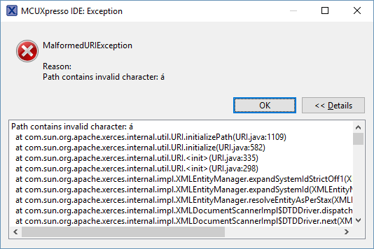

Unfortunatelly, problem is that my default location is:
c:\Users\Ján Harman\mcuxpresso\
... so the exception is raised if I select "New project..." even if SDK is in my not default location with valid path.
What to do?

jan_harman
Version:
MCUXpressoIDE_10.0.2_411
Log:

!ENTRY com.crt.utils 4 -1 2017-08-09 15:43:50.365
!MESSAGE Path contains invalid character: á
!STACK 0
com.sun.org.apache.xerces.internal.util.URI$MalformedURIException: Path contains invalid character: á

!ENTRY com.crt.utils 4 -1 2017-08-09 15:49:56.983
!STACK 0

!SUBENTRY 1 com.crt.utils 4 0 2017-08-09 15:49:56.989
!MESSAGE at com.sun.org.apache.xerces.internal.util.URI.initializePath(URI.java:1109)
!MESSAGE at com.sun.org.apache.xerces.internal.util.URI.initialize(URI.java:582)
!MESSAGE at com.sun.org.apache.xerces.internal.util.URI.<init>(URI.java:335)
!MESSAGE at com.sun.org.apache.xerces.internal.util.URI.<init>(URI.java:298)
!MESSAGE at com.sun.org.apache.xerces.internal.impl.XMLEntityManager.expandSystemIdStrictOff1(XMLEntityManager.java:2221)
!MESSAGE at com.sun.org.apache.xerces.internal.impl.XMLEntityManager.expandSystemId(XMLEntityManager.java:2053)
!MESSAGE at com.sun.org.apache.xerces.internal.impl.XMLEntityManager.resolveEntityAsPerStax(XMLEntityManager.java:968)
!MESSAGE at com.sun.org.apache.xerces.internal.impl.XMLDocumentScannerImpl$DTDDriver.dispatch(XMLDocumentScannerImpl.java:1152)
!MESSAGE at com.sun.org.apache.xerces.internal.impl.XMLDocumentScannerImpl$DTDDriver.next(XMLDocumentScannerImpl.java:1045)
!MESSAGE at com.sun.org.apache.xerces.internal.impl.XMLDocumentScannerImpl$PrologDriver.next(XMLDocumentScannerImpl.java:959)
!MESSAGE at com.sun.org.apache.xerces.internal.impl.XMLDocumentScannerImpl.next(XMLDocumentScannerImpl.java:602)
!MESSAGE at com.sun.org.apache.xerces.internal.impl.XMLNSDocumentScannerImpl.next(XMLNSDocumentScannerImpl.java:112)
!MESSAGE at com.sun.org.apache.xerces.internal.impl.XMLDocumentFragmentScannerImpl.scanDocument(XMLDocumentFragmentScannerImpl.java:505)
!MESSAGE at com.sun.org.apache.xerces.internal.parsers.XML11Configuration.parse(XML11Configuration.java:841)
!MESSAGE at com.sun.org.apache.xerces.internal.parsers.XML11Configuration.parse(XML11Configuration.java:770)
!MESSAGE at com.sun.org.apache.xerces.internal.parsers.XMLParser.parse(XMLParser.java:141)
!MESSAGE at com.sun.org.apache.xerces.internal.parsers.AbstractSAXParser.parse(AbstractSAXParser.java:1213)
!SUBENTRY 1 com.crt.utils 4 0 2017-08-09 15:49:56.990
!MESSAGE at org.xml.sax.helpers.XMLFilterImpl.parse(XMLFilterImpl.java:357)
!MESSAGE at com.crt.utils.xmlparser.XMLParser.parse(XMLParser.java:301)
!MESSAGE at com.crt.utils.xmlparser.XMLParser.parse(XMLParser.java:347)
!MESSAGE at com.crt.utils.xmlparser.XMLParser.parseXML(XMLParser.java:502)
!MESSAGE at com.crt.config.info.InfolistDB.parseTheXML(InfolistDB.java:409)
!MESSAGE at com.crt.config.info.InfolistDBCache.getCachedDB(InfolistDBCache.java:100)
!MESSAGE at com.crt.config.info.InfolistDB.createFromURL(InfolistDB.java:192)
!MESSAGE at com.crt.config.database.TargetConfig.getInfoFromPackage(TargetConfig.java:868)
!MESSAGE at com.crt.config.database.TargetConfig.modifiedVendorPackage(TargetConfig.java:1319)
!MESSAGE at com.crt.config.database.TargetConfig.setVendorPackage(TargetConfig.java:1665)
!MESSAGE at com.nxp.mcuxpresso.core.datamodels.ui.wizards.BoardDeviceSelectionPage.updateDescription(BoardDeviceSelectionPage.java:674)
!MESSAGE at com.nxp.mcuxpresso.core.datamodels.ui.wizards.BoardDeviceSelectionPage.createControl(BoardDeviceSelectionPage.java:542)
!MESSAGE at org.eclipse.jface.wizard.Wizard.createPageControls(Wizard.java:175)
!MESSAGE at org.eclipse.jface.wizard.WizardDialog.createPageControls(WizardDialog.java:696)
!MESSAGE at org.eclipse.jface.wizard.WizardDialog.setWizard(WizardDialog.java:1144)
!MESSAGE at org.eclipse.jface.wizard.WizardDialog.updateForPage(WizardDialog.java:1197)
!MESSAGE at org.eclipse.jface.wizard.WizardDialog.lambda$2(WizardDialog.java:1185)
!MESSAGE at org.eclipse.swt.custom.BusyIndicator.showWhile(BusyIndicator.java:70)
!MESSAGE at org.eclipse.jface.wizard.WizardDialog.showPage(WizardDialog.java:1185)
!MESSAGE at org.eclipse.jface.wizard.WizardDialog.nextPressed(WizardDialog.java:876)
!MESSAGE at org.eclipse.jface.wizard.WizardDialog.buttonPressed(WizardDialog.java:419)
!MESSAGE at org.eclipse.jface.dialogs.Dialog$2.widgetSelected(Dialog.java:618)
!MESSAGE at org.eclipse.swt.widgets.TypedListener.handleEvent(TypedListener.java:249)
!MESSAGE at org.eclipse.swt.widgets.EventTable.sendEvent(EventTable.java:84)
!MESSAGE at org.eclipse.swt.widgets.Display.sendEvent(Display.java:4418)
!MESSAGE at org.eclipse.swt.widgets.Widget.sendEvent(Widget.java:1079)
!MESSAGE at org.eclipse.swt.widgets.Display.runDeferredEvents(Display.java:4236)
!MESSAGE at org.eclipse.swt.widgets.Display.readAndDispatch(Display.java:3824)
!MESSAGE at org.eclipse.jface.window.Window.runEventLoop(Window.java:818)
!MESSAGE at org.eclipse.jface.window.Window.open(Window.java:794)
!MESSAGE at org.eclipse.ui.actions.NewProjectAction.run(NewProjectAction.java:115)
!MESSAGE at org.eclipse.jface.action.Action.runWithEvent(Action.java:473)
!MESSAGE at org.eclipse.jface.action.ActionContributionItem.handleWidgetSelection(ActionContributionItem.java:565)
!MESSAGE at org.eclipse.jface.action.ActionContributionItem.lambda$4(ActionContributionItem.java:397)
!MESSAGE at org.eclipse.e4.ui.internal.workbench.swt.PartRenderingEngine$4.run(PartRenderingEngine.java:1121)
!MESSAGE at org.eclipse.core.databinding.observable.Realm.runWithDefault(Realm.java:336)
!MESSAGE at org.eclipse.e4.ui.internal.workbench.swt.PartRenderingEngine.run(PartRenderingEngine.java:1022)
!MESSAGE at org.eclipse.e4.ui.internal.workbench.E4Workbench.createAndRunUI(E4Workbench.java:150)
!MESSAGE at org.eclipse.ui.internal.Workbench$5.run(Workbench.java:693)
!MESSAGE at org.eclipse.ui.internal.Workbench.createAndRunWorkbench(Workbench.java:610)
!MESSAGE at org.eclipse.ui.PlatformUI.createAndRunWorkbench(PlatformUI.java:148)
!MESSAGE at org.eclipse.ui.internal.ide.application.IDEApplication.start(IDEApplication.java:138)
!MESSAGE at org.eclipse.equinox.internal.app.EclipseAppHandle.run(EclipseAppHandle.java:196)
!SUBENTRY 1 com.crt.utils 4 0 2017-08-09 15:49:56.991
!MESSAGE at org.eclipse.core.runtime.internal.adaptor.EclipseAppLauncher.runApplication(EclipseAppLauncher.java:134)
!MESSAGE at org.eclipse.core.runtime.internal.adaptor.EclipseAppLauncher.start(EclipseAppLauncher.java:104)
!MESSAGE at org.eclipse.core.runtime.adaptor.EclipseStarter.run(EclipseStarter.java:388)
!MESSAGE at org.eclipse.core.runtime.adaptor.EclipseStarter.run(EclipseStarter.java:243)
!MESSAGE at sun.reflect.NativeMethodAccessorImpl.invoke0(Native Method)
!MESSAGE at sun.reflect.NativeMethodAccessorImpl.invoke(NativeMethodAccessorImpl.java:62)
!MESSAGE at sun.reflect.DelegatingMethodAccessorImpl.invoke(DelegatingMethodAccessorImpl.java:43)

!ENTRY com.crt.utils 4 -1 2017-08-09 16:02:32.077
!STACK 0

!ENTRY com.crt.utils 4 -1 2017-08-09 16:03:02.586
!STACK 0

!ENTRY com.crt.utils 4 4 2017-08-09 16:03:02.596
!STACK 0

!ENTRY com.crt.utils 4 -1 2017-08-09 16:03:09.938
!STACK 0
at com.nxp.mcuxpresso.core.datamodels.ui.wizards.BoardDeviceSelectionPage$2.selectionChanged(BoardDeviceSelectionPage.java:341)

!ENTRY com.crt.utils 4 4 2017-08-09 16:03:09.943
!STACK 0

!ENTRY com.crt.utils 4 -1 2017-08-09 16:19:26.269
!STACK 0

!ENTRY com.crt.utils 4 4 2017-08-09 16:19:26.285
!STACK 0

!ENTRY com.crt.utils 4 -1 2017-08-09 16:19:45.909
!STACK 0

!ENTRY com.crt.utils 4 -1 2017-08-09 16:19:48.715
!STACK 0
