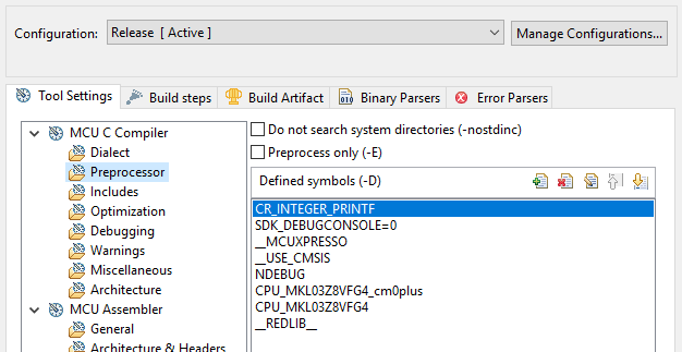

I am using MKL03Z8VFG4 (Kinetis KL03: 48MHz Cortex-M0+ Ultra-Low Power MCU, 8KB Flash, 2KB SRAM, 16-QFN).
My IDE is MCUXpresso v10.0.0 [Build 344].
I have built my custom KSDK 2.2.0  via https://mcuxpresso.nxp.com/en/builder.
Now, I have a literally empty main block in my program. I do nothing, no initialization. Only the startup code is there I guess. I have selected "Optimize for size" and my "Preprocessor symbol list" is below:

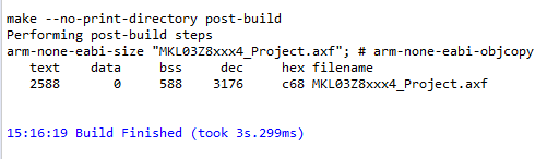

When I compile, the output size is  2588 and I did NOTHING! Keep in mind that this is an MCU with 8 kB flash.
What is the reason behind this and how can I reduce that?

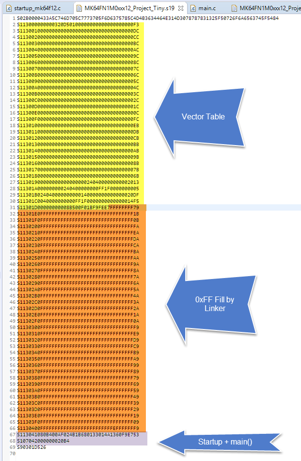

the 1K comes from the vector table and the filling up to 0x400. You can see this in the map file (example for K64F):
Around 500 bytes for the vectors:
 *(.isr_vector)
 .isr_vector    0x00000000      0x198 ./startup/startup_mk64f12.o
and the linker fills up the FLASH up to 0x400:
.text           0x00000000      0x424
 FILL mask 0xff
(that filliing is questionable in my view, as this space could be easily used for constant data or code, but it seems this is how the Kinetis SDK is by default generating the linker file).
If you create a S19 file (see MCUXpresso IDE: S-Record, Intel Hex and Binary Files | MCU on Eclipse ), you can easily see this too:
In above example, the startup code is directly calling main() which is basically 'empty'.
