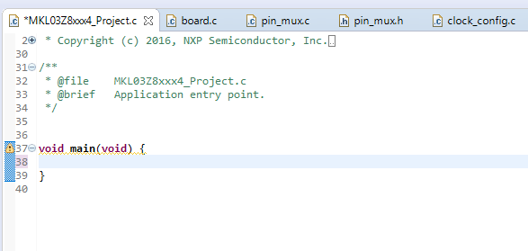

Now, I have a literally empty main block in my program. I do nothing, no initialization. Only the startup code is there I guess. I have selected "Optimize for size" and my "Preprocessor symbol list" is below:
When I compile, the output size is  2588 and I did NOTHING! Keep in mind that this is an MCU with 8 kB flash.
What is the reason behind this and how can I reduce that?

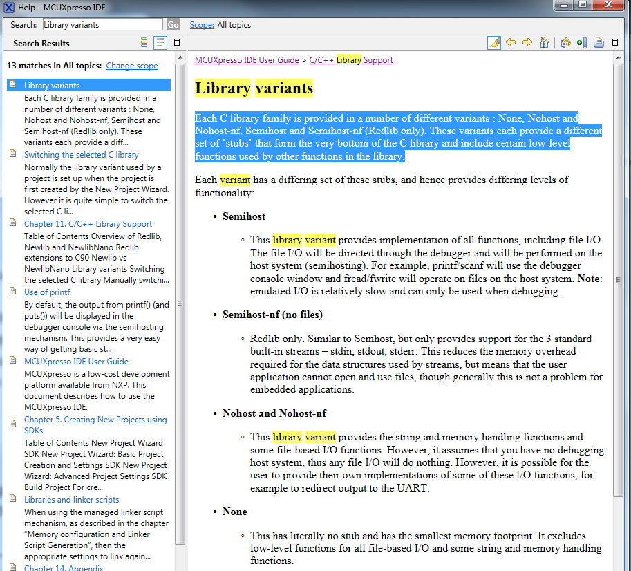

To reduce the code size, I suggest you choose Redlib(none) or Newlib(None) as library type when creates a new project. see attached video.
Each C library family is provided in a number of different variants : None, Nohost and Nohost-nf, Semihost and Semihost-nf (Redlib only). These variants each provide a different set of ‘stubs’ that form the very bottom of the C library and include certain low-level functions used by other functions in the library.
for more information about library variants, Please see MCUXpresso help

ZhangJennie

when you use other library for creating project, for example, Redlib(semihost), the project will include io functions for semihosting code. For example, _fdopen, _fclose,etc. Thus the project code size gets increased.
if use Redlib(none), this function  is not included.

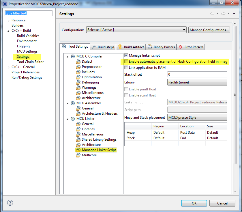

The 1 KB code includes interrupt vector table, handler, startup code, user source code, flash configuration code.
Because flash configuration field starts from 0x00400, the "gap" above 0x00400 is filled with 0xFF,  that causes the total "text" size over 1k.  If we uncheck "Enable automatic placement of Flash Configuration field in image", you will see the code size down.
attached are two hex file generated with the same project.
MKL03Z8xxx4_Project_INCLUDE_FLASHCFG.hex   - with "Enable automatic placement of Flash Configuration field in image" checked.
MKL03Z8xxx4_Project_NO_FLASHCFG   - with "Enable automatic placement of Flash Configuration field in image" unchecked.
you will see the difference.
