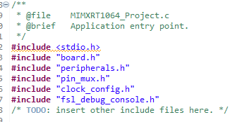

Hi everyone,
I'm using MCUXpresso 24.9.
For some reasons in my project I needed to chnge the compiler command line. The chenges are working fine, the project is built without problem.
But there is a side effect: the indexer is not able to resolve lib include files:

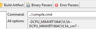

To debug the problem I created a test program with the default options (New Project -> Create a new C/C++ project), then I changed the command line to compile the project (Project properties -> C/C++ Build -> Settings -> MCU C compiler) from the default value ("arm-none-eabi-gcc") to "../compile.cmd":
The file compile.cmd is located in the project directory and contains the single line:
arm-none-eabi-gcc %*
If I compile the program the process is terminated without errors, but all the c library files are highlighted as unresolved inclusions: so the problem belongs only to the indexer.

I did a step ahead.
If I set the command line to compile the project with the absolute path of compile.cmd file (C:/MyProject/compile.cmd), the unresolved inclusions decorations disappear.
So I tried to use the PROJECT_LOC path variable, but it seems it's not expanded and I have build errors too.
Is there a way to give the indexer a relative path to the compile.cmd file? Or even an absolute path depending on the project location?
I need the project location can be changed, because of different project developers drive path.

Now I'm able to configure an absolute path depending on the project localtion. It need to use the ProjDirPath path variable, as on this image:
However, the real project is a very complex project and the command line exceeds the 8191 character limit, so I cannot use the Windows .cmd batch file.
Because Git is installed on my PC, I can use a .sh shell file.
The file compile.sh is located in the project directory as compile.cmd and contains the following lines:
#!/bin/sh
arm-none-eabi-gcc $@
Although with compile.sh file the project is built with no errors, using a .sh file leads to the same problem: the indexer is not able to resolve lib include files.
