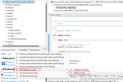

I am trying to use the Hello World demo to see how the terminal works using mcxc242.
I am using teraterm. I can see PRINTF correctly, but GETCHAR() or SCANF() to send values from the keyboard does not seem to work.
Is there anything I need to enable?
Thank you for your reply.

Please test using the SDK demo hello_world. I have tested it on the FRDM-MCXC242 board, and the GETCHAR() function works properly.
Please choose UART console on SDK Debug Console:
If you still have issues, please check your hardware connections—specifically, whether the UART RX pin is connected correctly.
If you are using your own custom board, you may also send us your schematic for reference. If you are using an NXP DEMO board, please take a photo of the jumpers, I help you check.

It works on the integrated console, but not on Teraterm or other Terminal.

Are you using the UART or semihosting for your input/output?
Typically, most terminal views do not support semihosting, but built-in terminal views in the IDE might support it.
And if using semihosting, most implementation do only implement output, no input. If you want input, you have to use a library like this one: https://mcuoneclipse.com/2023/03/09/using-semihosting-the-direct-way/

With semihost, both input and output work via the mcxpresso console, whereas if I enable it with uart, I see it working on the teraterm terminal only in output, not in input. I am not using the external debugger, only USB.
I don't really care which mode I choose (UART or semihost), the important thing is that I can get the characters from the keyboard via Teraterm.
What should I do? Is it possible without an external debugger?

Yes, you can read from the UART console too.
Can you check your _read() function? This is where it gets the data.
