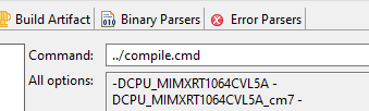

To debug the problem I created a test program with the default options (New Project -> Create a new C/C++ project), then I changed the command line to compile the project (Project properties -> C/C++ Build -> Settings -> MCU C compiler) from the default value ("arm-none-eabi-gcc") to "../compile.cmd":
The file compile.cmd is located in the project directory and contains the single line:
arm-none-eabi-gcc %*

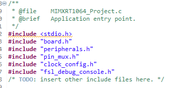

If I compile the program the process is terminated without errors, but all the c library files are highlighted as unresolved inclusions: so the problem belongs only to the indexer.

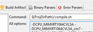

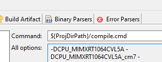

Now I'm able to configure an absolute path depending on the project localtion. It need to use the ProjDirPath path variable, as on this image:
However, the real project is a very complex project and the command line exceeds the 8191 character limit, so I cannot use the Windows .cmd batch file.
Because Git is installed on my PC, I can use a .sh shell file.
The file compile.sh is located in the project directory as compile.cmd and contains the following lines:
#!/bin/sh
arm-none-eabi-gcc $@
Although with compile.sh file the project is built with no errors, using a .sh file leads to the same problem: the indexer is not able to resolve lib include files.
