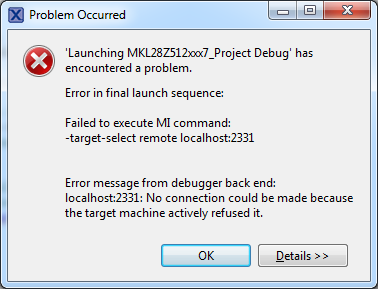

Debugging the hello world example from MCUXpresso IDE using a JLinkPro debugger gives the error "Failed to execute MI Command" "exec-run" "Don't know how to run." How can I fix this to enable debugging?
This is using the SDK_2.x_FRDM-K82F kit at Version 2.6.0 built for MCUXpressoIDE toolchain.
In the GDB trace log I can see it looks like the exec-run command was unknown.  I've included this and other logs in the attached file but the relevant contents are:

The Console Tab:
[03-7-2019 01:07:28] Executing Server: "C:\Program Files (x86)\SEGGER\JLink\JLink.exe" -nosilent -swoport 2332 -select USB  -telnetport 2333 -singlerun -endian little -noir -speed auto   -port 2331    -vd -device MKL28Z512xxx7 -if SWD -halt -reportuseraction
SEGGER J-Link Commander V6.44i (Compiled May 17 2019 17:35:18)
DLL version V6.44i, compiled May 17 2019 17:34:22
Unknown command line option -nosilent.
Server has been shut down.
The windows message box:

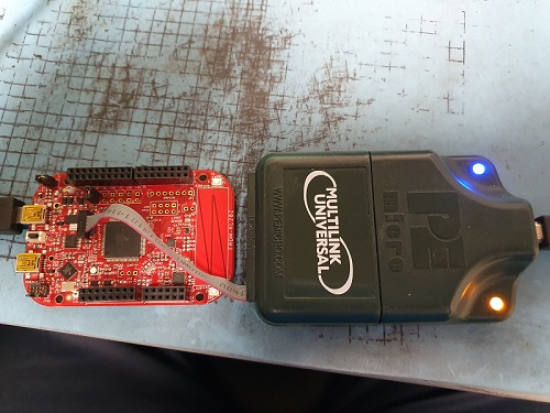

As I mentioned, powering the FRDM-KNL28Z from the target USB and using the PEMico's Multilink Probe,
the project can be debugged.

When I added the Segger Jlink debug, I get:
When I added the PEMicro:
The project does erase, download,verify and allows stepping with the MKL28Z512 10 pin debug. I have FINALLY found a probe that can function.

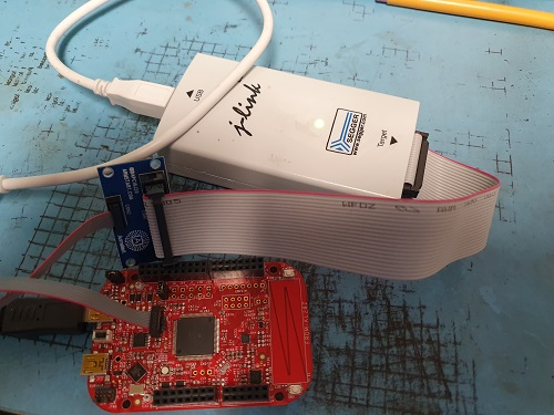

From your pictures I see you are powering the board from the OpenSDA USB connection. This is fine (essential) for OpenSDA debug but not for debug via external probes.
I am able to duplicate your debug problem when powering from the OpenSDA USB and debugging with SEGGER.
Please try powering the board from the target device USB connection i.e. the lower one when using SEGGER JLink or P&E.

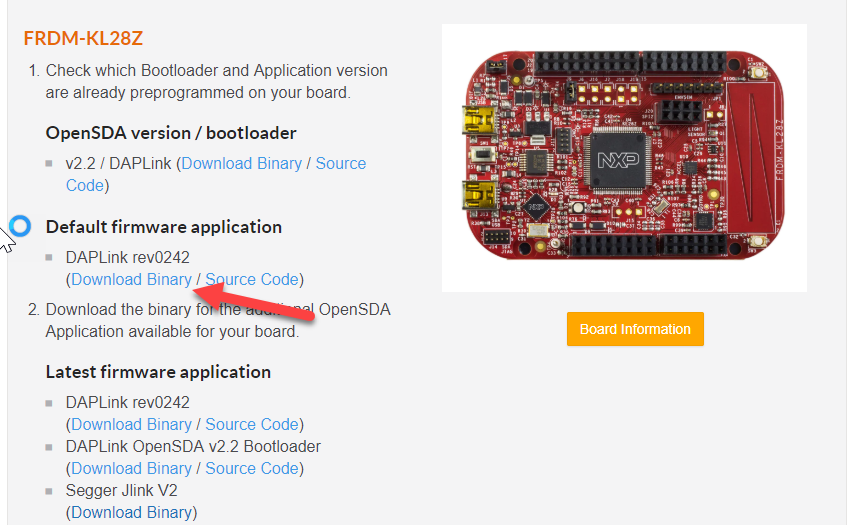

After dropping k20dx_frdmkl28z_if_crc.bin found in "OpenSDAv2.2_DAPLink_frdmkl28z_rev0242.zip"
My FRDM-MKL28Z project did download using USB SDA, and as a bonus... stopped at main... and as a super bonus, can single step.
Magic combination sauce:
1. MSD bootloader "0244_k20dx_bootloader_update_0x8000.bin" found DAPLink bootloader update | Mbed
2. SDA bootloader "k20dx_frdmkl28z_if_crc.bin" found in "OpenSDAv2.2_DAPLink_frdmkl28z_rev0242.zip"
3. J-link version "JLink_Windows_V647d.exe" found SEGGER - The Embedded Experts - Downloads - J-Link / J-Trace
4. MCUexpresso "MCUXpressoIDE_11.0.0_2516.exe"

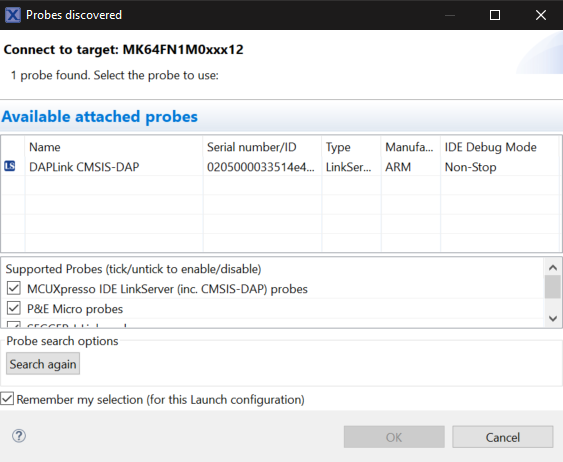

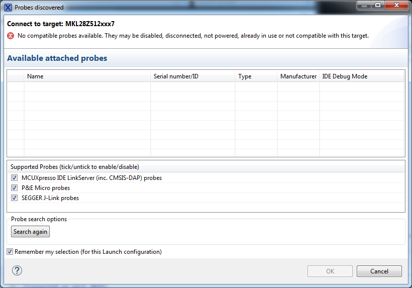

No blue button, when I press Debug in the Quickstart panel I get:

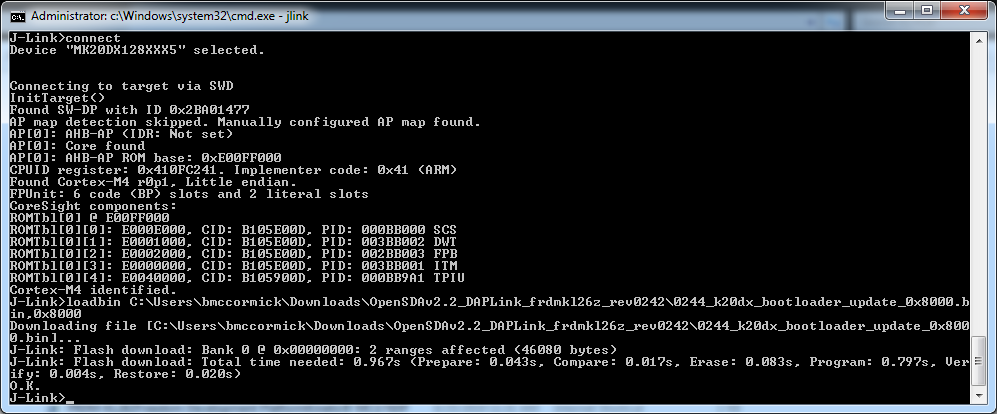

benmccormick

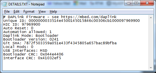

Now at version 2.44
Found "0244_k20dx_bootloader_update_0x8000.bin" binary at:
After copying the binary into the folder, Had to loadbin with 0x8000 offset:
J-Link>loadbin C:\Users\bmccormick\Downloads\OpenSDAv2.2_DAPLink_frdmkl26z_rev0242\0244_k20dx_bootloader_update_0x8000.bin,0x8000
Now after a reset, reboot:
Now to try the blue button.

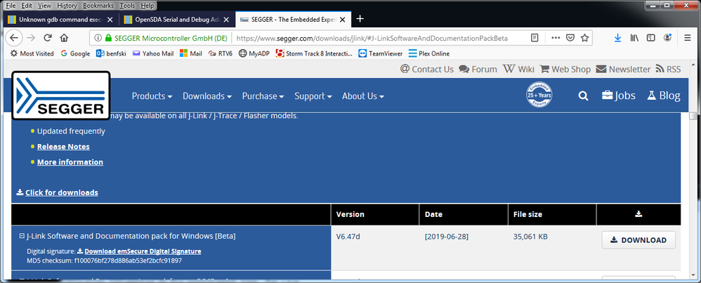

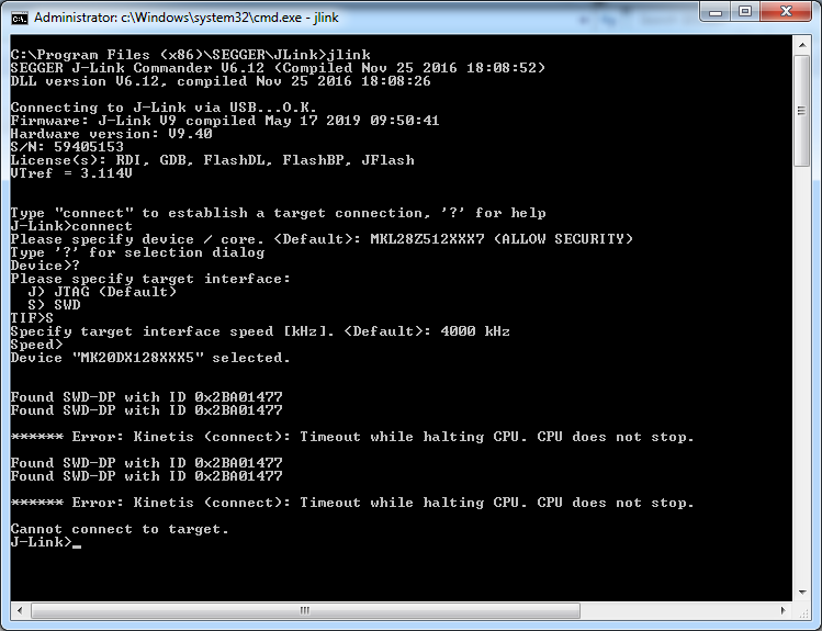

benmccormick
Noticed that your Jlink.exe was at V647a, I used V6.12. Couldn't find V647a, but did find V647d, no legacy selection in the Beta.
When first connecting with V647d, couldn't connect, tried powering up on the target USB port, couldn't halt CPU, then powered back up on SDA USB, looks like it did download the bin file:
Yet another brain fade. I noticed that the link to the bootloader actually was to the FRDM-KL26 NOT FRDM-KL28Z,
so needless to say, it doesn't bootup when the reset button is held and released. I guess its time to go home now.

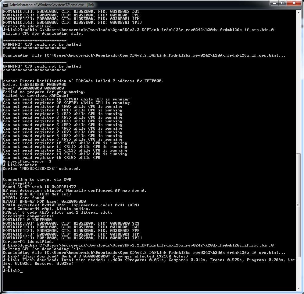

benmccormick
After noticing the USB was on the SDA port and mine wasn't, after switching to the SDA port, here was the loadbin results:
pastedImage_2.pngAfter rebooting into the bootloader:
Looks like the download did fail, still at version 2.41
19,375 Views
benmccormick
Thanks Alexis for the detailed example.
The link to https://www.nxp.com/downloads/en/snippets-boot-code-headers-monitors/OpenSDAv2.2_DAPLink_frdmkl28z_r...
took me to:
Page Not Found
The page you requested cannot be found.
After Googling "OpenSDAv2.2_DAPLink_frdmkl26z_rev0242.zip" I found where to download it at:
DAPLink downloads missing from site

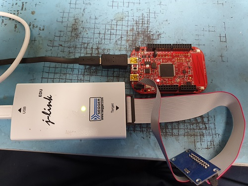

benmccormick
Its gotten worse now and not better. I've uninstalled MCUXpressoIDE_11.0.0_2516.exe, then installed MCUXpressoIDE_10.3.1_2233.exe.
   I read in a previous thread someone said 10.3.1 used to work. It didn't.
  Then I went back to 11.0.0 and now when I press Debug in the in the Quickstart Panel, no probe is found.

I have tried the PE Multilink RevB and RevC debugger and neither of those work either in either the 10pin or SDA mode.
I have tried the Segger EDU J-Link probe connected to the 10-pin debug port and it also fails.

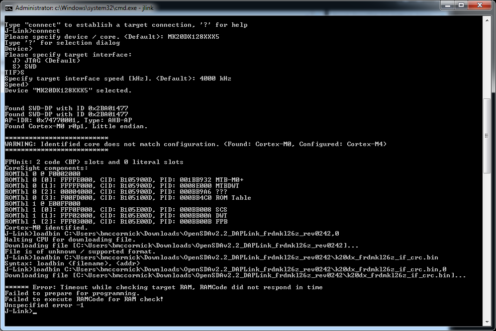

Alexis_A

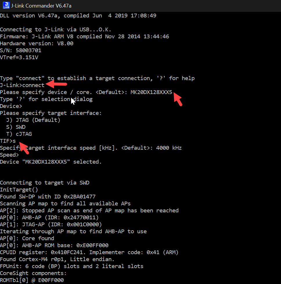

Hi Ben,
Can you try using this file to load this file using the external debugger?
Using the J-Link debugger connected to the SWD 10-pin connector near the OpenSDA connector, this will give you access to the MK20 in the board.
Using the J-Link commander console execute the next commands:
- connect
-? (Search for the MK20Dx128XXX5)
-s (select SWD)
-(Enter) (Default)
The log should be like the next one:
Then to download the OpenSDA use the command loadbin:
-loadbin (path), 0
And the MCUXpresso should recognize the device after clicking the blue bug, as the next image:
In case you want to debug the target MCU (KL28Z), you should connect the debugger to the other SWD 10 pin connector.
Let me know if this helps you.
