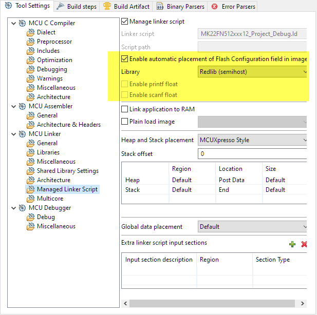

ErichStyger
Specialist I
could it be that you changed something in the linker settings? I would compare those.

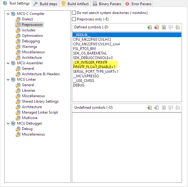

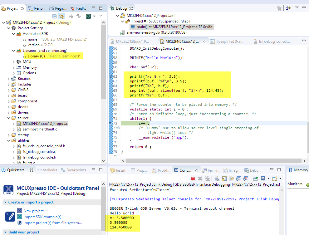

ErichStyger
Specialist I
this is what I have:
