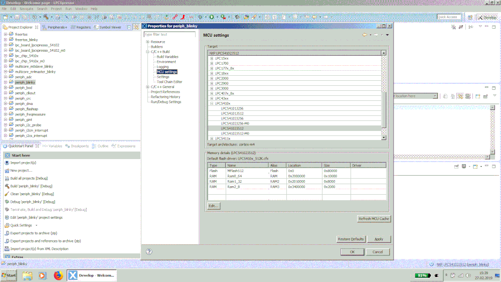

schoelch_frank
Device selection should be correct as shown in the picture. This is preconfigured in the project periph_blinky contained in the zip-file lpc5410x_lpcxpresso_3.01a.zip of the Examples folder of LPCXpresso.
Could someone of the NXP team test if there's an issue with the compatibility of LPCXpresso 8.2.2_650 and the Demoboard OM13077?

converse
Senior Contributor V
A couple of things
- when using LPCscrypt you are connecting to, and programming the on-board debugger - not the target chip. So, running 'query part' will read the part number of the LPC43xx that is the debugger.
- are you sure your target is an LPC54102J512. I have seen a similar problem when attempting to debug the wrong part. It is vitally important that the IDE know exactly what the part number of the debug target is.

schoelch_frank
I checked the device setting and it's fine. Also I installed LMPXpresso on a different computer and it shows exactly the same issues. I even received a second new demoboard and it does not work. I tried to program the flash manually and got the following log:
