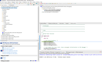

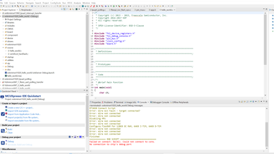

Prudhvi_Raj
Tried to debug sdk by MCUXpresso IDE ,occuring a error such as target reported errors .provide solution as soon as possible.
Refer to the attachment.

Harry_Zhang
Hi @Prudhvi_Raj
On another board, i reproduced this issue.
When i changed to jlink.
It can work.

Harry_Zhang
Hi @Prudhvi_Raj
I tested my board,
It can work.
I watched your error message,
It reported that the wire not connected,
So can you change another wire?

Harry_Zhang
Hi @Prudhvi_Raj
According to the picture, this error is due to not connecting to the core.
So please check if this board is powered on and if it is connected to the debug port.
Hope this will help you.
