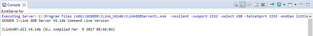

The paramters in MCUXpresso you can find in the console view:
Executing Server: C:\Program Files (x86)\SEGGER\JLink_V614b\JLinkGDBServerCL.exe  -nosilent -swoport 2332 -select USB -telnetport 2333 -endian little -noir -speed auto -port 2331  -vd -device MK64FN1M0xxx12 -if SWD  -nohalt -reportuseraction

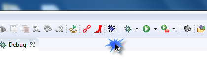

another thing, the blue debug icon on my MCUXpresso IDE is gray, I can not click it, I have to start debug on Quickstart panel.

And with regards to the green button, as stated above and in the documentation - we generally do not recommend using it. It is a standard Eclipse button and does not (currently at least) integrate into the MCUXpress IDE auto-probe detection and launch configuration creation system. This is why we recommend using the Quickstart Panel's Debug option (inherited from LPCXpresso IDE).

There is defect in MCUXpresso green debug button if use Jlink as interface.
From my test, if use green debug button with Jlink, It will generate incorrect launch file, that results the fail connection with Jlink. This is a known issue and this will be fixed in next release.
With current MCUXpresso 1.0, to work with Jlink, I suggest use blue debug button as below. From my test, there is no issue with it.
Currently I don't have a K22 board in hand. If you want, please let me know. I can create a video for you when I get a board tomorrow.
