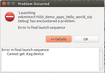

Hello I am using MCUXpresso IDE, version v10.1.0 [Build 589] [2017-11-14] with an MIMXRT1050-EVK SDK, version  2.3.0 (2017-11-16).  I am attempting to download and debug the hello_world_xip example via a Segger J-Link Plus but I am running into the following error:
I have reviewed the IDE user manual and other posts in other NXP forums which appear to be very similar but the suggestions have had little no no effect. i.e. 890826, 447820, 891538
Once the error has occurred, it will occur instantly with each new debug attempt and I can not attempt the connection process again without a reboot of the IDE.
The j-link console shows what appears to be a successful connection to the processor followed by a sudden "Server has been shut down." message.  I see no obvious errors in the the GDB and JLinkServer output.

682,411 12^exit‍‍‍‍‍‍‍‍‍‍‍‍‍‍‍‍‍‍‍‍‍‍‍‍‍‍‍‍‍‍‍‍‍‍‍‍‍‍‍‍‍‍‍‍‍

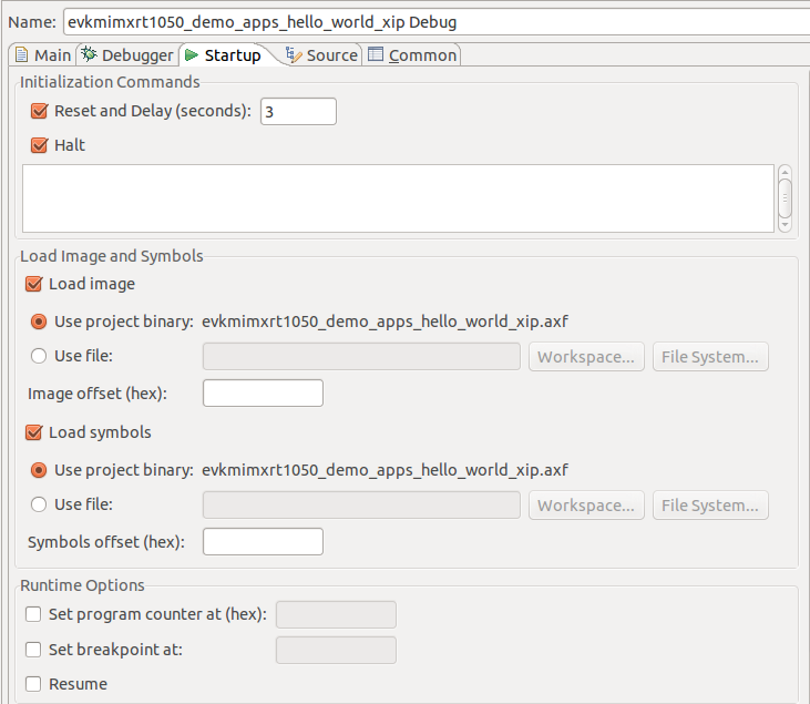

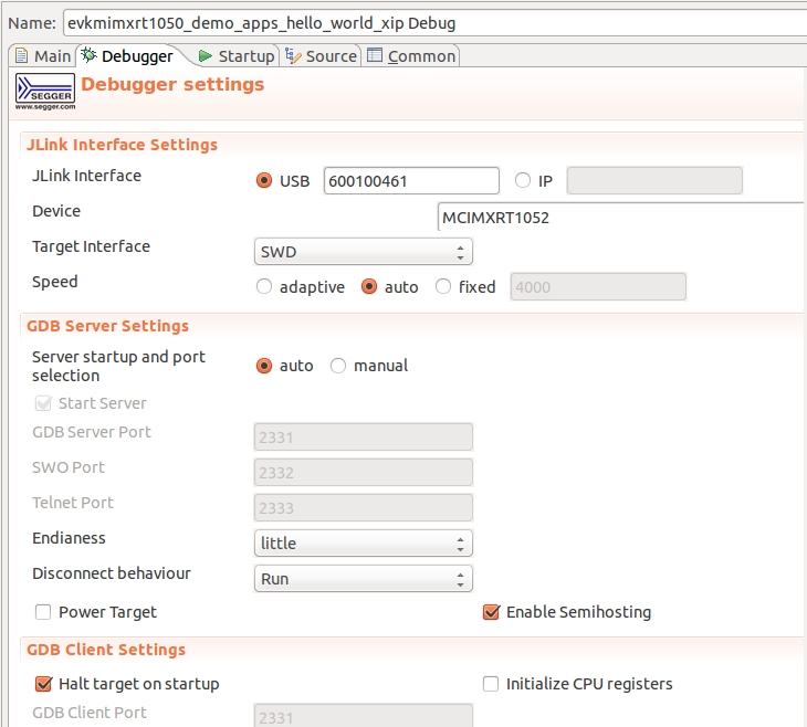

Here is my J-link setup:
The "Source" and "Common" tabs are in their default state.
Any insight into the j-link error would be appreciated, thanks.

Fixed, you have to right-click on prroject -> Launch Configurations -> Create New -> Segger J-Link Probes (or what ever your new probe is).  All subsequent debug attempts will use that config. until changed again.
Do not attempt to create launch configurations manually, this just leads to unusual issues.
