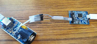

Following this topic: https://community.nxp.com/t5/MCUXpresso-IDE/How-to-just-upload-a-binary-file/m-p/1305736 , here is now my new problem.
With
- a KL25 based pcb
- the software MCUXpressoIDE with a KL25 project
- a probe "MCU-link"
- a SWD cable from the pcb to the probe (i shortened it to 10 cm ; see attached picture)
I was able to upload BIN files without problem, until i uploaded a BIN file with secure Flash.

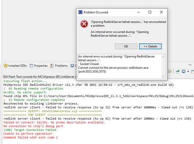

Now each time i execute "Target operation > masse erase" with the script "kinetismasserase.spc", after around 20s (with my oscilloscope, it looks like the probe it trying to communicate with the pcb during this period), there is an error message (see attached screenshot). Then the MCU-link probe is not found anymore even after usb unplug/replug. I have to restart the OS to get the probe visible again.

looking at your picture with the debug connection, I only see 4 wires but I would expect 5: GND, Vsense, Reset, SWDIO and SWDCLK.
Erich

Of your 'secure' image, what is the security settings? If mass erase is disabled, then you won't be able to regain access to the device (see https://mcuoneclipse.com/2014/06/22/preventing-reverse-engineering-enabling-flash-security/ and https://mcuoneclipse.com/2012/11/04/how-not-to-secure-my-microcontroller/ ).
The other thing you have to consider as possible difference between your two boards is the reset circuit (RESET line) and what you have there (pull-ups, C): The debug probe tries to reset the MCU, and this can fail for several reasons or if you have a pull-up too strong or a C too big this might be difficult. Or if your reset pin has been re-configured or your debug block on the device. What might help you is a faster debug probe (the MCU-Link is good, but not that fast), so you might have better luck with a J-Link or a Multilink. With a Multilink you can try access to the device with power cycling too, see https://mcuoneclipse.com/2021/05/20/recovering-cortex-m-microcontroller-with-a-power-glitch/

offin
Hi Erich,
Thank you for your answer.
Here are the uploaded data (see attached screenshot)
After checking.
The interesting byte is EF (0xef = b11101111).
bxxxxxx11 = SECURED
bxxxx1100 = Factory access granted
bxx10xxxx = Mass erase DISABLED
b11xxxxxx = backdoor key access DISABLED
So, yes the mass erase is disabled. Sorry, i did not know it was possible to disable that.

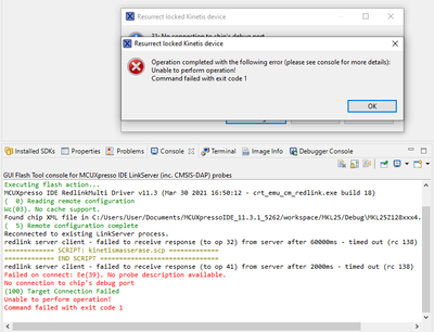

lpcxpresso_supp
Have you tried the "resurrect" functionality offered by the GUI Flash Tool?
Greetings,
MCUXpresso IDE Support
9,214 Views
offin
I confirm that the "Resurrect" function does not help. Here is a screenshot of the result.
Capture d’écran du 2021-08-30 11-47-59.pngCapture d’écran du 2021-08-30 11-47-59.png
And after this operation, the software does not find anymore the MCU-Link probe. I have to restart the OS and then it works again.
So i think this pcb is definitely out of order. I am working now with the new fresh arrived ones.
