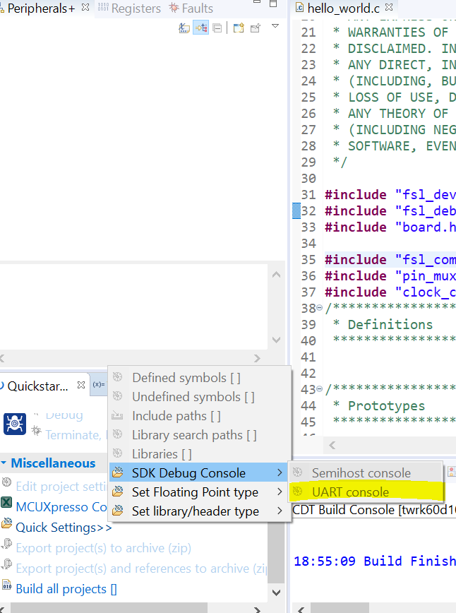

I want to save serial data that comes from my K60_dev_board but i can't get an access with MATLAB to the serial com port data i use the P&E prob to do a  debug and show data with MCUxpresso console, can someone help me to do this.

Omar_Anguiano
Hello Amine
Make sure that the SDK debug console has marked UART.
This will allow you to display the data for UART.

aminesedki_as
Hello Omar,
Thanks for u quick reaction, actually i set the UART in MCUxpresso IDE, but i get an incorrect data i don't why Capture.JPG

aminesedki_as
I use PRINTF to print float
4,289 Views
aminesedki_as
Actually the PRINTF with float number work fine with the semihost console
4,289 Views
aminesedki_as
I found the solution the problem now is the speed synchronization between the transmission and reception line
