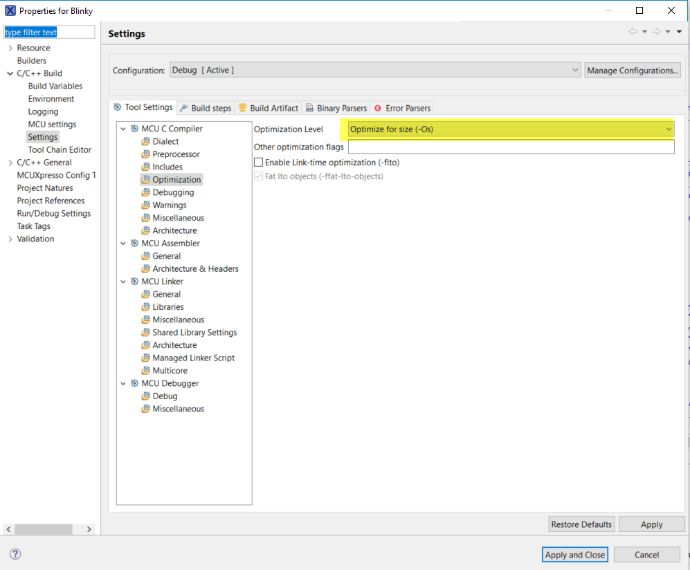

Hello Boris Fiedler ,
You can directly use the Debug mode to build ,debug and download.
If you want to add some optimization, you can also config on it.
TIC
5,237 Views
boris_fiedler
Hi Alice,
Thank you very much for your answer...
I knew that I can set the optimization level also in the debug mode, which makes the source code smaller / optimal.
It was more of a general question, why compiling in the release mode does not work, because the necessary files do not appear in the Makefile and where i can change it.
Many Thanks
Boris
