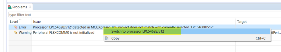

I have imported a project into MCUXpresso v10.
It is for the 54608 MCU but my development board is the 54628.
The code seems to run OK but I would like to change to the correct MCU.
I have both SDK's installed.
When I go to Properties MCU Settings and select the 54628 I get hte warning that the project may not build properly.
This seems to be the case.
The config file (MEX) is not correct (not changed) and the config tool (v5) shows the H/W configuration as the old MCU (54608). I cannot seem to correct this?
What are the correct steps to changing the MCU?
3,053 Views
Hello  Adrian Neal ,
Right click the error message, then choose  "Switch to processor LPC54628xxx"
as below:

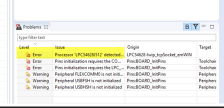

Hello Adrian,
Please have a look about the Problems view on your attachment :

Hi Adran,
Just open the attachment you attached in your original post.
