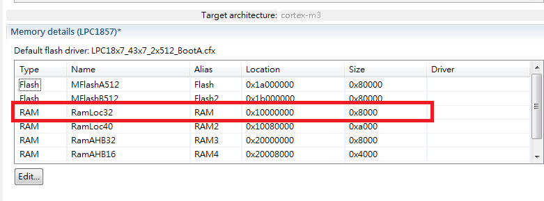

I am using 1857 and MCUExpresso, I run the freeRtos sample project,
When I add more task, I find the app crash when I run.
I guess the crash cause is the stack not enough, because of the following test:
I calculate my total stack is about 36K. It's bigger than RAMLoc32,
I switch the RamLoc40 to the first Ram Area.
The app can run successfully.
At first, I thought the compiler will allocate all stack automatically with all RAMLoc32,  RAMLoc40, RAMAHB32, RAMAHB40 since the project had add these RAM.
Should I do special process for using other RAM area if my stack is not enough, not automatically by compiler?

You can't merge those RAM blocks - they aren't contiguous. But you could locate your stack into the 40KB block instead of the 32KB block by changing the "Heap and Stack Placement" dialog in the Linker Settings.

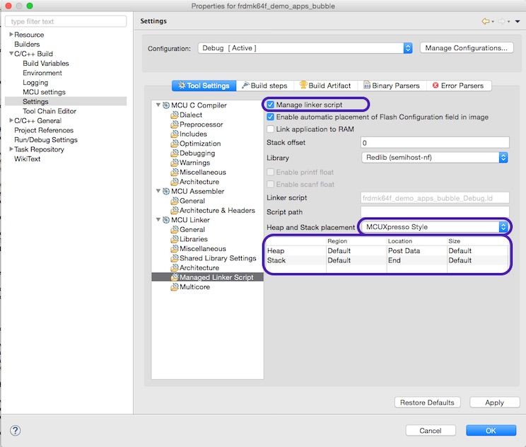

MCUXpresso IDE offers two modes of stack placement - LPCXpresso style and MCUXpresso style. For an LPC18xx project, your project is likely to be configured by default to LPCXpresso style.
But in either case, the stack is always by default placed at the end of the RAM region listed first in the memory configuration editor (and the application data and heap are placed at the start of the first RAM region). But this is completely configurable.
The easiest way to move the stack is probably to switch to using MCUXpresso style heap/stack placement and use the table provided in the Managed Linker Script page of the Project Properties to chage the RAM region your stack is placed into....
For more information, please read the MCUXpresso IDE v10.0.0 User Guide, in particular section 12.9: "More advanced heap/stack placement".

kensu
Contributor V
Dears
I want to confirm again. for 3'rd, 4'rd RAM that I want to use.
Should I just add it into link setting? Same as the second RAM I want to use,
Ken
6,998件の閲覧回数
kensu
Contributor V
Thanks you for fast reply, I follow the step, and my problem is solved. "It is so easy".
