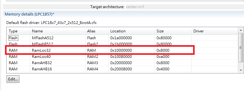

I am using 1857 and MCUExpresso, I run the freeRtos sample project,
When I add more task, I find the app crash when I run.
I guess the crash cause is the stack not enough, because of the following test:
I calculate my total stack is about 36K. It's bigger than RAMLoc32,
I switch the RamLoc40 to the first Ram Area.
The app can run successfully.
At first, I thought the compiler will allocate all stack automatically with all RAMLoc32,  RAMLoc40, RAMAHB32, RAMAHB40 since the project had add these RAM.
Should I do special process for using other RAM area if my stack is not enough, not automatically by compiler?

lpcxpresso_supp
You can't merge those RAM blocks - they aren't contiguous. But you could locate your stack into the 40KB block instead of the 32KB block by changing the "Heap and Stack Placement" dialog in the Linker Settings.

kensu
Contributor V
Thanks, I understood now.
The internal ram can not merge, so if my application stack is more than heap total size,
I need to allocate some some application memory to other internal SRAM.

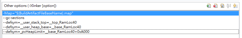

I am using LPC1857JET256 with MCUXpresso, I run the freertos sample code, and I add 9 task,
each task is using 4K stack, so total stack is more than 36K (RamLoc32), so the application seems crash.
So I follow the guild of MCUXpresso user guild, I add second ram with the linker setting.
I want to confirm firstly,
Is my setting correct? (If I want to add second ram to stack use.)
RamLoc32 + RamLoc40 should be 72K size, but my application still have problem when I keep to add the tasks.
For example:
I add a task which do nothing, my purpose is to test the stack size. When I add a task, other task function is not correct.
And I decrease all task stack size, the task function work fine again.
So I think there are still something wrong with the stack size setting.
Could you check my setting is correct?
Ken

lpcxpresso_supp
MCUXpresso IDE offers two modes of stack placement - LPCXpresso style and MCUXpresso style. For an LPC18xx project, your project is likely to be configured by default to LPCXpresso style.
But in either case, the stack is always by default placed at the end of the RAM region listed first in the memory configuration editor (and the application data and heap are placed at the start of the first RAM region). But this is completely configurable.
The easiest way to move the stack is probably to switch to using MCUXpresso style heap/stack placement and use the table provided in the Managed Linker Script page of the Project Properties to chage the RAM region your stack is placed into....
For more information, please read the MCUXpresso IDE v10.0.0 User Guide, in particular section 12.9: "More advanced heap/stack placement".
MCUXpresso IDE Support

kensu
Contributor V
Thanks you for fast reply, I follow the step, and my problem is solved. "It is so easy".
Actually, I am not totally understand the setting of stack/heap, I will keep to study it.
