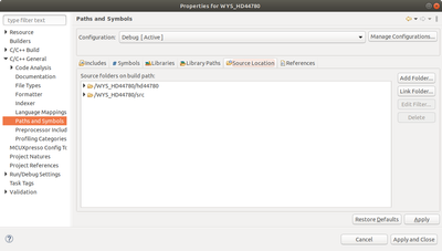

I am using MCUXpresso IDE v11.5.1 [Build 7266] [2022-04-13].
I added icludes path to "${workspace_loc:/${ProjName}/hd44780}"
I added source location to "WYS_HD44780\hd44780"
However, when building, I have a message undefined reference to... What am I doing wrong ?

Your first screenshot doesn't include "src" path. please add it.
Besides, I suggest you importing a lpcopen demo code, refer the demo code path settings to set your project path.
If the problem persists, please upload your project here, thus we can check it directly.

I checked all the settings, it turned out that I deleted the file hd44780.c from the added folder hd44780.
The function prototypes were in the file hd44780.h and the functions were missing hence the undefined reference message.
