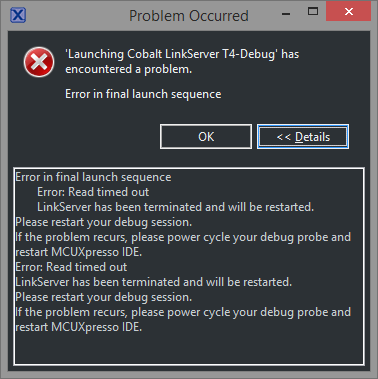

I mentioned in another thread that I'm having new problems with the LPC-Link2 today.  I'm creating this post to cover those.
I changed nothing from yesterday's configuration; I left the system running overnight to try to catch a usage fault, caught it, and got an instruction trace.  When trying to launch again, I started getting errors.
This continued after power cycling the target and the LPC-Link2, manually killing redlinkserver.exe since the cleanup button doesn't always do it, and restarting the IDE.  I rebooted the system completely, power cycled everything again, and got the same thing.  After power cycling the probe yet again, it's back to a different error:
Mind you, this is *after* successfully downloading the firmware image and starting it.  I don't know what component this might be coming from.  The target is running at this point, though.
It's *not* a problem with the connection to the target - I moved the cable from the LPC-Link2 to my Cyclone ACP without touching the end connected to the target, and the Cyclone runs fine.  The P&E gdb software did automatically update this morning, but that was after the problems had started.
Any ideas?

The "Clean up Debug" button basically just kills all of the SEGGER, P&E and LinkServer related debug executables, including GDB. You should be able to see this if you have task manager running before you hit the button. The fact that you still see redlinkserv still running afterwards almost suggests that something in your environment is reopening it, though I can't think of why this might happen. Do you maybe have the redlinkserv console open in the IDE's console view?
With regards to the "Target not available" popup, this looks like it might be related to having the Disassembly View open at the time you start the debug session. Is this the case for you? Certainly in our investigation here, it looks like in such circumstances the underlying Eclipse functionality appears to be trying to access the target to populate the view before the debug connection is actually live. We'll investigate further to see if there is anything we can do to mask this in a future release, but otherwise the message is basically benign.

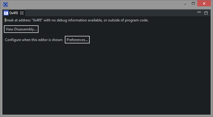

Since it's still running I think you're right, that it's just a timing problem.  Like the fact that it almost always brings up at least one window like this every time it starts:
If it's benign I can live with it, though the little annoyances do add up.  As Erich recently pointed out on his blog, the instruction trace config requires you to close and open the view to load saved settings, and I've pointed out places in the debug configuration dialogs before where you have to click one tab and come back to another to get a button to update.  None of these stop you from using the features, you just have to remember the little dance you have to do for each one.
