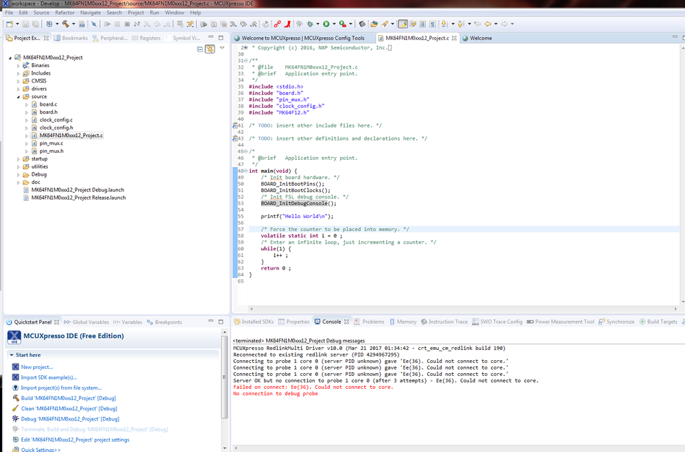

I will be very pleased if anyone could help me resolve this issue.... what is the cause of this error message ? The board is fully functional as I have tested it on a different machine. I will like to understand the cause of this error message and what's the fix !   I have attached a screenshot as well .
MCUXpresso RedlinkMulti Driver v10.0 (Mar 21 2017 01:34:42 - crt_emu_cm_redlink build 190)
Reconnected to existing redlink server (PID 4294967295)
Connecting to probe 1 core 0 (server PID unknown) gave 'Ee(36). Could not connect to core.'
Server OK but no connection to probe 1 core 0 (after 3 attempts) - Ee(36). Could not connect to core.
Failed on connect: Ee(36). Could not connect to core.
No connection to debug probe

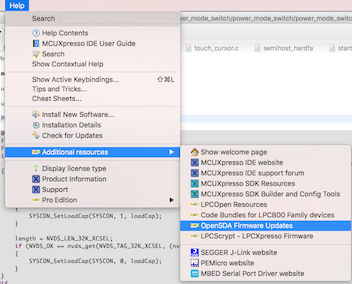

MCUXpresso IDE contains a link to the OpenSDA Firmware page on nxp.com via the menu:
  • Help -> Additional Resources -> OpenSDA Firmware updates
These are the firmware variants we tend to use in developing the IDE (and using the DAPLink versions of CMSIS-DAP where available), though we generally only update boards when we initially receive the boards - or need to swap between CMSIS-DAP <> P&E <> SEGGER firmware variants

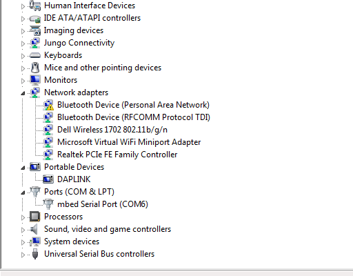

Am using the FRDM K64F with the firmware 0243_k20dx_frdmk64f_0x5000
I have installed all the necessary drivers...where is the problem ? or what do I have to do?

There are several debug firmware for FRDM K64F, I would suggest you try others. Please refer this document.
https://community.nxp.com/docs/DOC-105199
Besides, I would suggest you create a new workspace and new project for testing the connection, to avoid old association.
