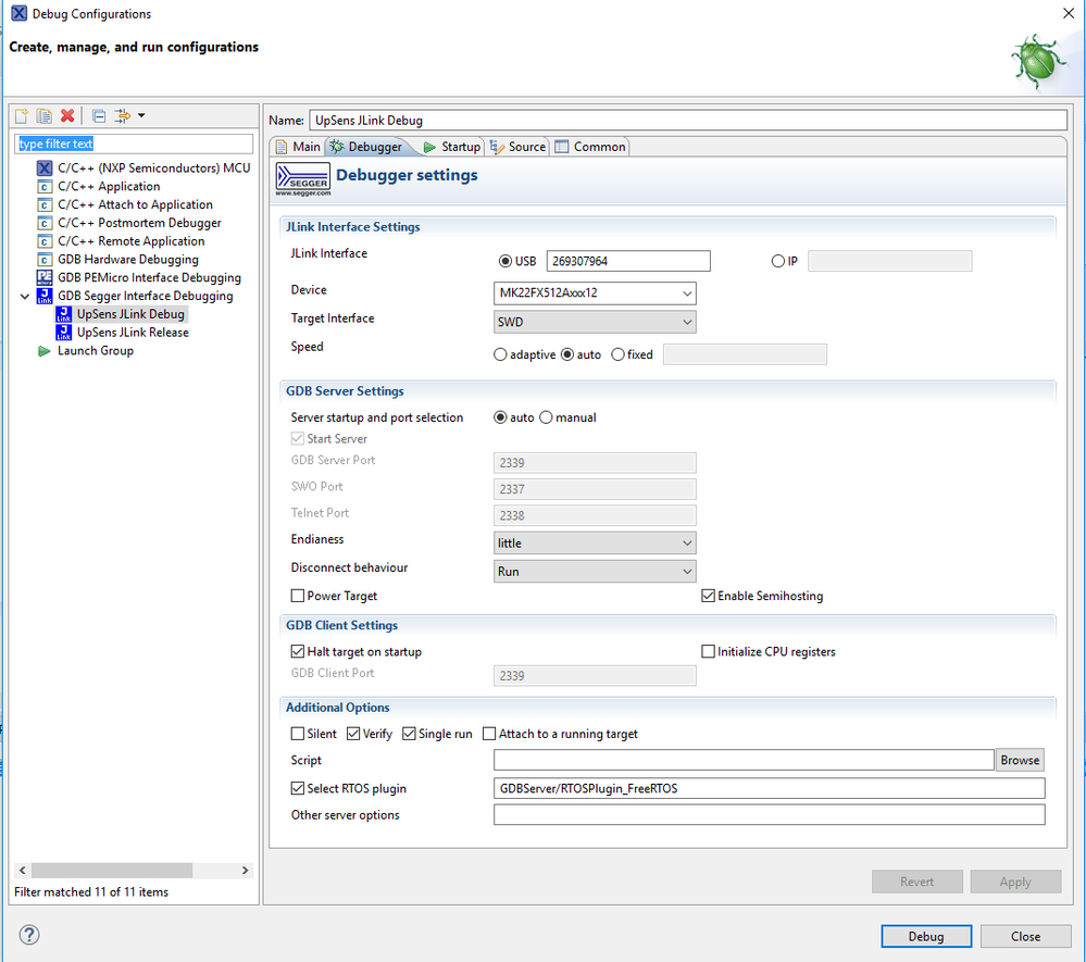

Hello i have a problem setting breakpoints with a firmware that use the Freertos. I have different thread so i want to use the Thread Aware Debugging.
I have this setting
but there is this error in red:

ERROR: FreeRTOS maximum used priority is unreasonably big, not proceeding: 00000072.

can you help me?
in FreeRTOSconfig.h i have set
#define configMAX_PRIORITIES (8)

Hello and thanks,
i have find the solution following this post BUG: KDS debug call-stack fails with Segger JLink
I have Create a dummy symbol uxTopUsedPriority (will be preferred to uxTopReadyPriority) and set it to configMAX_PRIORITIES.

Hi Daniel,
I suspect something is overwriting your RAM. It seems that your uxTopUsedPriority variable has the value 0x72 which is indeed too high and does not make any sense.
I recommend to increase the task stack size (see Troubleshooting Tips for FreeRTOS Thread Aware Debugging in Eclipse | MCU on Eclipse ), and if this does not help, set a watchpoint on uxTopUsedPriority (see C/C++ Watchpoints with Eclipse Kepler | MCU on Eclipse , same principle works with MCUXpresso IDE too).
I hope this helps,
Erich
