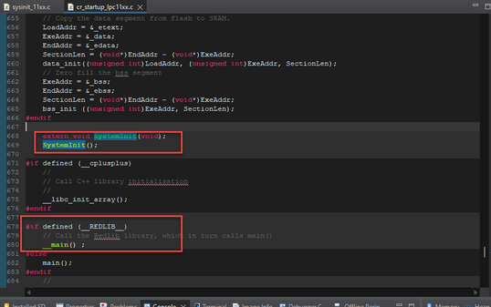

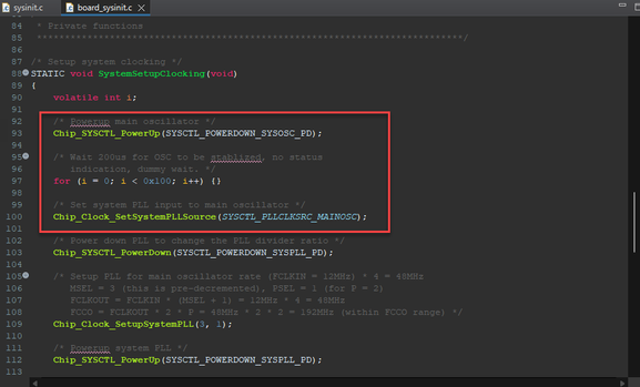

As mentioned in the Reference Manual (RM), the MAINCLKSEL register is initially set to 0x0. However, in the MCUXpresso example, it is modified to use the PLL as the main clock source. I’ll provide an example using the blinky_project to illustrate this:
If we look at the ResetISR available in the startup code, we can see that it calls the function SystemInit(), which is responsible for setting up and initializing the hardware before calling main(). This includes configuring the PLL as the main clock source.
After SystemInit(), the main() function is executed.
You can also use the function "Chip_Clock_SetSystemPLLSource" to change the main system clock, provided the necessary configurations are in place.
