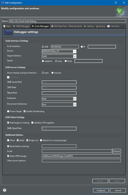

Hi Keith,
thanks for sharing the details.

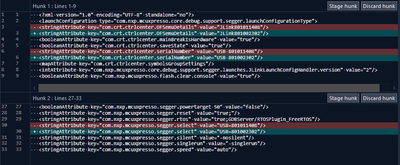

I tried to reproduce the same on my side. I have this:
MCUXpresso IDE 10.2.1 with SEGGER J-Link GDB Server V6.46k
I have two different J-Link (EDU mini) with different USB IDs, on different USB ports (if this matters)
Two boards (same firmware, hardware). Debugging one board with one board with one J-Link. Commit .launch file. Then debugging the other board with the different J-Link. Here is what gets changed on my side:
So the USB ID gets changed for me in three places. But the RTOS plugin setting does not get touched for me. As a reference I have attached my .launch.
This is how it looks in the UI:
I hope this helps,
