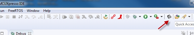

Hi!
I'm starting to do some work with the KL25Z development board and using MCUXpresso 10.1 and the OpenSDA from P&E probe. When I use the "debug 'xxxx' [debug]" option from the Quick panel, the program starts to debug as expected, I click the 'resume' button and all works fine, however I wonder if there is any way to only flash the code into the MCU without have to go throughout the 'Debug session'. I just want to flash the code on the MCU and look at it works without have to handle anything else on the IDE.
Thank you for your support.
Greetings from México!
3,649 Views
ZhangJennie
MCUXpresso IDE integrates GUI Flash Programmer but it only works for NXP LinkServer debug connection (LPC-Link, LPC-Link2, CMSIS-DAP) (e.g. no support for Segger J-Link or P&E Multilink)
another choice is using debugger. see introduction:
https://mcuoneclipse.com/2017/05/06/using-eclipse-to-program-binary-files-to-an-embedded-target/
NXP doesn't  have standalone GUI programmer SW for Kinetis, but our 3rd party company has. for example PEmicro's PROG for ARM® Cortex™ Processors flash programmer software
