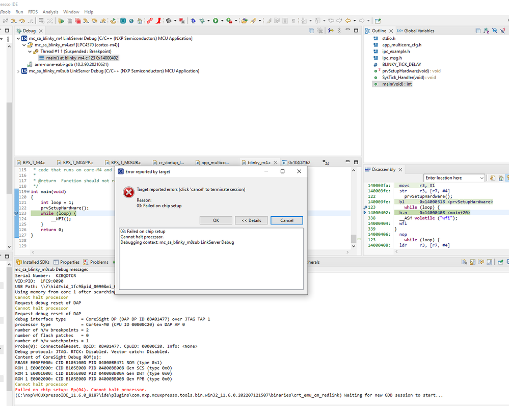

I am using 2 LPC-LINK2 connected with each other. I am trying to run the mc_sa_blinky example. However, I have not been able to run the m0sub and m0app projects at all. I first started the debug session for the m4. Then, I attempted to start the m0sub debug session; however, I got the error "Failed on chip setup: EP(04). Cannot halt processor." I hope you can provide detailed instruction on how to start debug session for multicore projects.mc_sa_blinky_debug.PNGmc_sa_blinky_debug.PNG

Please refer to below thread:
https://community.nxp.com/t5/LPC-Microcontrollers/Which-IDE-to-be-used-for-debugging-LPC4367/m-p/871...
It includes how to use mcuxpresso ide debug multicore project with lpc43xx.
