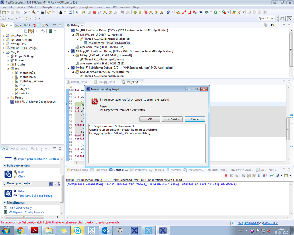

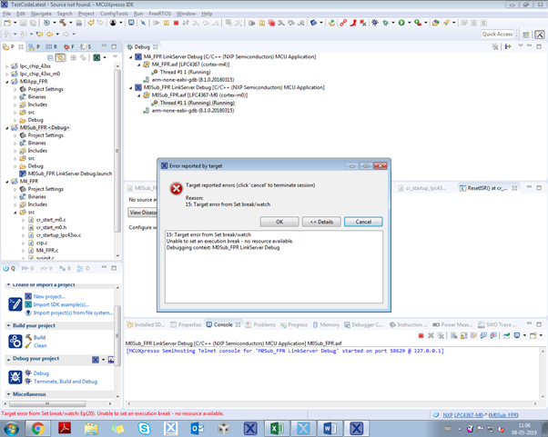

I am working on the development of one of our product. There i am using LPC4367 tricore controller for my development. Initiatially i did the evaluation on OM13088 eval board along with LPCXpresso v8.2.2_650. But later i downloaded MCU Xpresso V10.3 for the development but i found that there is a problems which i faces with the MCU  Xpresso IDE listed below Which is not observed in LPCXpresso IDE
1. It never programs for the first time. For that I need to terminated and debug and ther it fails and then I need to kill the debug connection and again initiate after that it programs
2. After terminating also it always shows error that the core priority is already occupied. Then again I need to follow the steps mentioned in point 1.
3. While debugging when I put M4 and M0App core In debugging mode then its ok but when I put M0sub core in debugging more then it shows Redlink erro 255 then for that again I need to clean , delete the launch and debug folder and recompile it and then program
If in case i need to do modification then it take lot of time to just do all these activity to just put the controller in debugging mode.

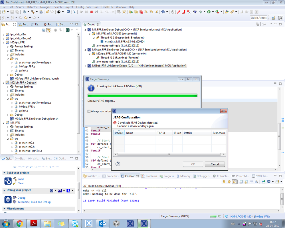

Hi Guarav,
I have looked at the issues you have raised and tested your simple application on the LPCXpresso LPC4367 evaluation board. I am unable to duplicate the programming issues you report so all I can do is offer some advice.

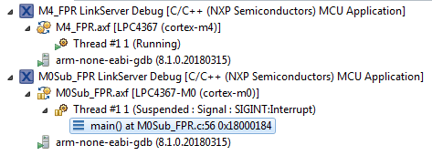

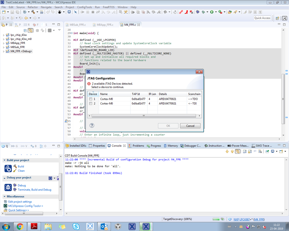

The model for multicore debug is that the Master (linked) project programs the code and data for all cores - therefore this will be 'Debugged' first and the M0 cores must only be 'Attached'.
Care must be taken with a number of issues.
Be sure to connect the appropriate projects to the required cores (over JTAG) for this device.
The M4 core is automatically selected by the IDE when a debug operation is performed. This operation will program all the required code to flash. RAM code as used by the M0Sub is placed by the M4 start up sequence - Therefore I recommend that the M4 project is run once it has been programmed.

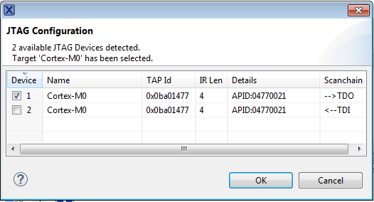

The M0 Sub has to be manually selected the first time (as below) - this setting will be remembered inside the projects build configuration folder.

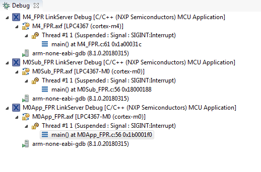

Once the the M4 project has been run, and the M0 sub attached, you can pause the M0 sub and see it running at the correct (expected) address.
You will also see the automatically created launch configuration for the M0Sub set to show it will attach on 'Debug' via the 'A' decorator (shown below).
The remaining M0App project will automatically select the remaining M0 core. You can then attach this and run and pause all of the projects (together or singly) and see something like below:
Step within this debug stack to see scope and core displayed in the various debug views.

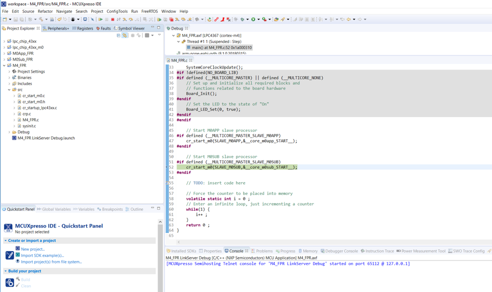

I will follow the steps as you mentioned below but there is one confusion regarding the steps that you mentioned where you launched M0Sub project after M4Core and before launching M0App core project you run and M4Core project and stop at  M0Sub core project.
Then you lanched M0App project. Is it possible, the reason behind asking this is that in M4 porject in main at the initialization it runs both the core with the statement mentioned below.
// Start M0APP slave processor
#if defined (__MULTICORE_MASTER_SLAVE_M0APP)
cr_start_m0(SLAVE_M0APP,&__core_m0app_START__);
#endif
// Start M0SUB slave processor
#if defined (__MULTICORE_MASTER_SLAVE_M0SUB)
cr_start_m0(SLAVE_M0SUB,&__core_m0sub_START__);
#endif
So already it has run the M0App core and you have not yet launched the M0App core. So will it not give any error while launching M0App project?
Just let me know if I have mentoine in proper way as per your input. Please confirm this then i will initiate the process since i will be testing it it on my development board as well so there should not be issue with the controller moving ahed.

lpcxpresso_supp
Hi Gaurav,
> Thanks for the quick reply and it Gaurav not Guarav :-).
Apologies, it is not a name I have come across before... better than being called MCUXpresso IDE Support :smileywink:
In this model of MultiCore debug, the M4 master project (and Core) is responsible for both placing the data (and code for RAM) and starting the M0 cores running. No debug connection is required to achieve this - a POR would of course do the same.
The M0 projects contribute code into the M4 master project but when debugged (via attach) - they do not provide any debug control of the M0 cores - until they are paused of course.
Furthermore, attempting to pause the M0 core(s) before they are started (by the M4 core) will likely result in a poor debug experience.
So at a basic level, I recommend debugging the M4, this will reach main(), then start it running. Then you can make the M0 connections in any order you please. Any further debug control can be achieved via breakpoints as required.

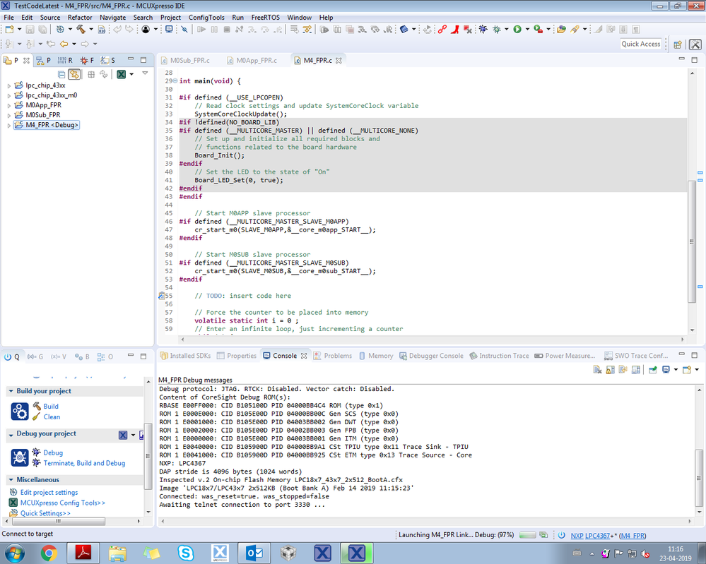

As pe your input and suggestion I followed your procedure but before that i did mass erase and then recompiled all the project one by one. After mass erase I initiated for the first time to debug then the IDE stuck at one point mentioned below
It stuck for long time so to come out of this loop I did Clean up to kill the active debug components.

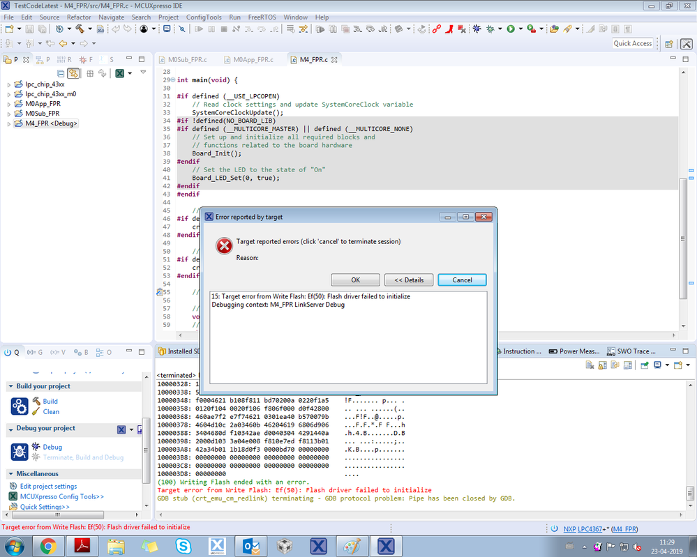

Again initiated to debug the M4 Project. But again got stuck in the below mentioned point. so to come out of this loop I did Clean up to kill the active debug components.
Deleted the launch and .jtag file of M4 project and again initiated to debug the M4 Project. Again got stuck in the below mentioned point. so to come out of this loop I did Clean up to kill the active debug components.

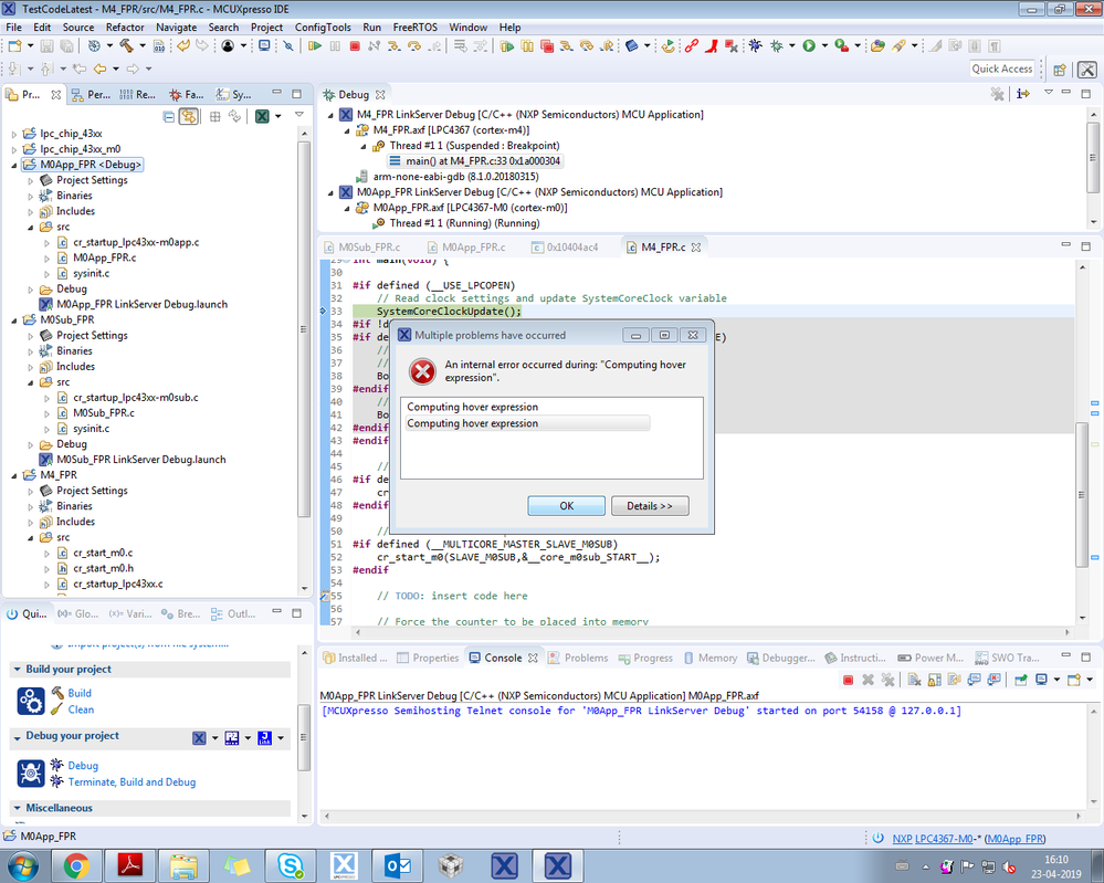

Then I Reset the controller and then click on debug icon and it got programmed. The I tried to programme M0Sub project and I got this error.
I don’t understand why it gives this error shown below.
“  15: Target error from Set break/watch
  Unable to set an execution break - no resource available.
  Debugging context: M0Sub_FPR LinkServer Debug”
Then I clicked to cancel to terminate the session. Then it terminates both M4 and M0Sub session. Again initiated to debug the M4 Project and I got below error,
Again I need to do Mass erase using GUI flash tool to reinitiate debugging, Then the M4 Project was programmed.
Then initiated to launch debug for M0Sub Project. And it got programmed
Then I initiated to launch debug for M0App Project. Then I got the same error again,
Now this time it is for M0App project and every time when this error comes and I click on OK ot goes to ResetISR(void) function of M0App Project.
Again I need to do Mass erase using GUI flash tool to reinitiate debugging for all the Projects.
I am able to programme M4 Project but while launching M0Sub project it again gives error
Now this is a random behaviour since sometimes it comes for M0App and sometimes it comes for M0Sub but for M4 Project it gets launched successfully every time. when I click on OK to goes to ResetISR(void) function of M0Sub / M0AppProject.
This all the procedure I tried with the older version of the MCUXpresso V10.1 in  my laptop, there also for the first time when i did  mass erase and then inititated the programming it programmed all the core / Project but when I do relaunching after termination it shows "Target error from write flash EF(50)"
Then i have to do Mass erase using  Regaining debug access to target MCU  and tried to relaunch the project , than it is observed that M4 Core is programmed successfully all the time but when it come to M0App and M0Sub project it is the random behaviour and it goes to the reset ISR function as already mentioned above.
 I am not able to get the reason for the error
"15: Target error from Set break/watch
Whats is the cause for this error. If no resource available then why for the first time it  got programmed successfully? . This happens when we terminate the debugger and agian relaunch the debug session.

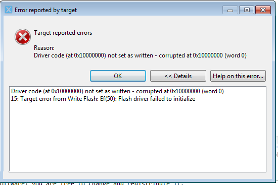

When i tried using MCU Xpresso then the memory got corrupted and it give me error, Refer the attached MCUXpress Error.txt file.
Then I again tried with the LPCXpresso IDE then also it gives me error mention below.
Now I am not able to program that controller and my development board got wasted, I want to recover from this so please let me know how to come out of the issue and reprogram the code and remove the memory corruption issue.

Following are the observations:

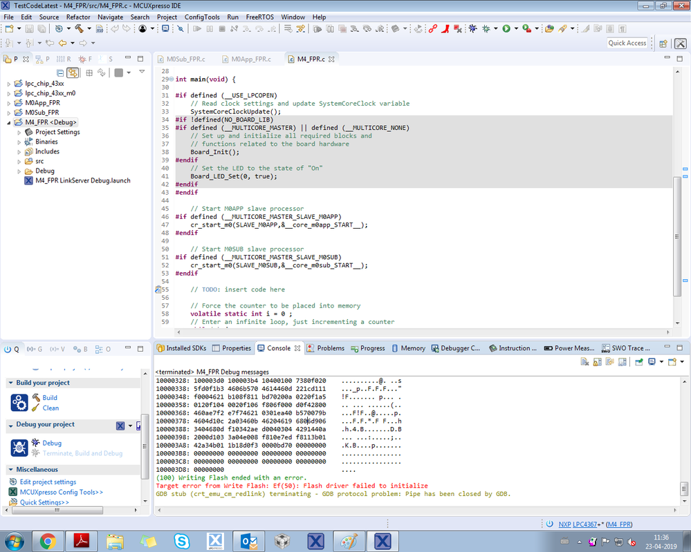

After the compilation I choose M4_FRR project to download and debug. But while doing the same I faced following error and  I was not able to download and debug.
You can see I was not able to program and it got stuck. This behaviour is observerd for both the board (Development board and Eval board OM13088). To come out of this condition I clicked on "TerminateBuildandDebug" option. After clicking of this option I got following error.
You can see that the MCUxpresso IDE was unable to detect M4 core. Again this is the same observation in both the boards (Development board and Eval board OM13088). Then to over come this I clicked on "Clean up Debug " option and again reinitiate to download and debug M4_FRR project. Then I got the folowwing error.
You can see that "Target error from flash write Ef(50)" occurs. So I deleted the debug and launch and did cleaned the build the project again and initiate to download and debug M4_FRR project. I was not able to down load and debug and  got follwing error.
You can see    "Target error from flash write Ef(50)" occurs again. Then  I tried with LPCXpresso as well but same error occurs since there was a corruption in memory. Then as per the Regaining debug access to target MCU  post I performed following operation

When I click on cancel button it terminated all the other cores as well. Again this is the same observation in both the boards (Development board and Eval board OM13088). When I click on ok  (after getting the same error again ) then the M0Sub core  program is in ResetISR function and it is stuck there even if i tried to reset the code by using "move to line" option in debugging mode. After that i again tried to download and debug but then the same error "Target error from flash write Ef(50)" occurs again (mentioned above). One more thing while I was performing the same in LPC eval board  and when tried to reprogram M0Sub core I got following error
Then I did cleanup Debug and deleted the launch and dedug and reprogrammed  but the same error "Target Srror from Set break /watch "
Then i performed the same using LPCxpresso IDE and there everything works fine.
While downloading using MCUXpresso in case of Eval board I was able to reprogram but then while loading M0App _FPR project it gives follwong popup but i was able to debug.
I clciked ok and proceed further but when started downloading the M0Sub_FPR project then again the following error ocurs
I case of LPC expresso I was able program download and debug all the time. So over all I can see that there is a problem with the MCU Xpresso while dowloading the program for the first time, while Downloading third core (M0App / M0Sub). I tried by clicking on Skip all break point opting  doubting that there migh be more breakpoint set but atill no success.
I would sugest you to do the same opertion and download and debug all the three cores since in you mentioned feedback above you have only M4_FPR project. Download and debug others as well with the same tescode project I shared already.

Hello Gaurav More,
I test on my side, yes, there is some problem using MCUXpresso IDE debug LPC4367 with dual cores.
I will report it to IDE development team.
Now you can use LPCxpresso IDE to debug .
