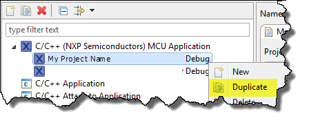

  6. Stop debugging and go to LPCLink2 debug configurations.
  7. Right-click on the configuration created automatically and select "Duplicate"

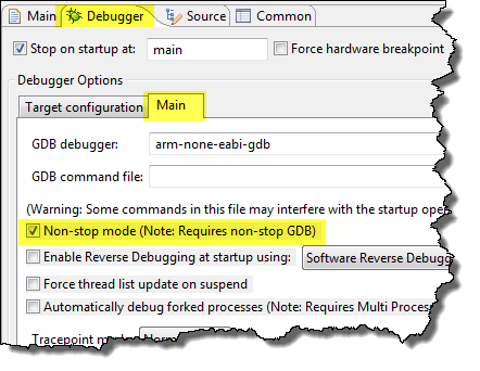

  8. On the duplicated configuration go to the Debugger Tab, Main, and check "Non-Stop Mode"
  9. Click Apply.
  10. Click Debug.
  11. The debug session will start and break at main like usual.  However, when I press play I no longer have the "Pause" option available, it is grayed out.
  12. It does stop at breakpoints and I am able to step when it breaks, but I don't have the option to pause.  Also, when I press the red "Terminate" button it does not actually disconnect from the target.  In task manager arm-non-eabi-gdb.exe is still running.  I have to restart MCUXpresso after killing the arm-none-eabi-gdb task to be able to debug again, or it says a session is already deployed.

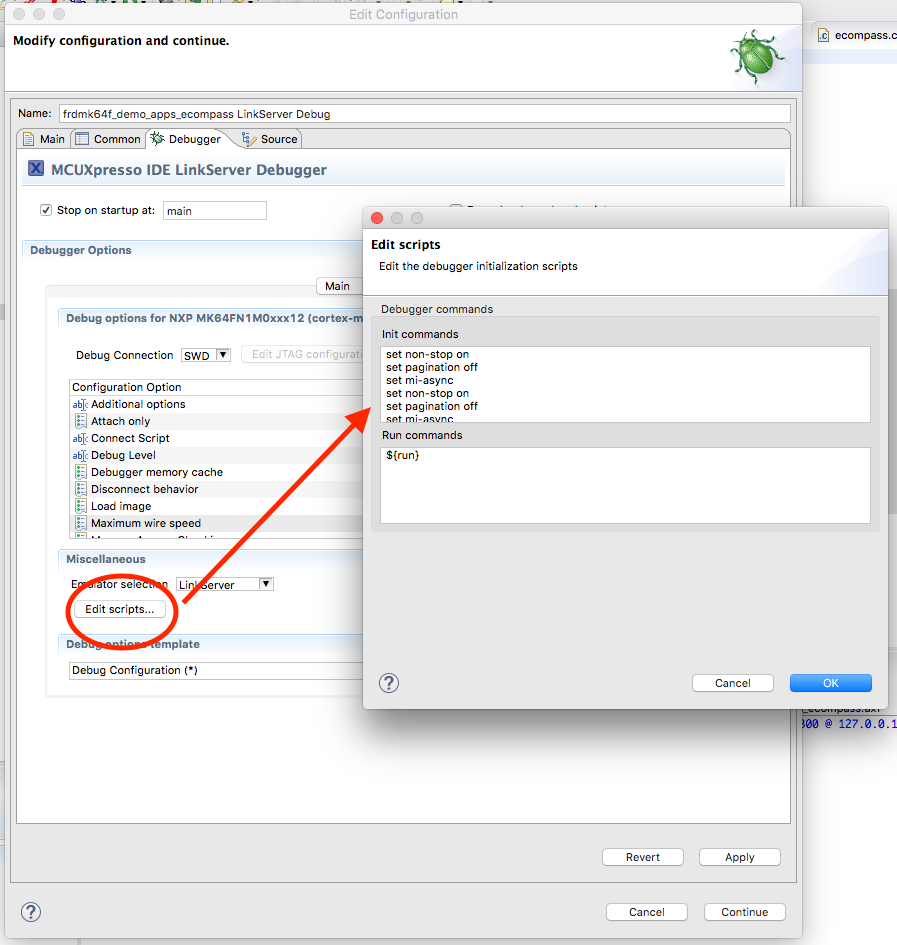

the NonStop mode needs the following commands in the GDB init section of your debugging configuration:
  • set non-stop on
  • set pagination off
  • set mi-async
MCUXpressoIDE Support Team

jschepler
Thank you.  Debugging works as expected now.
