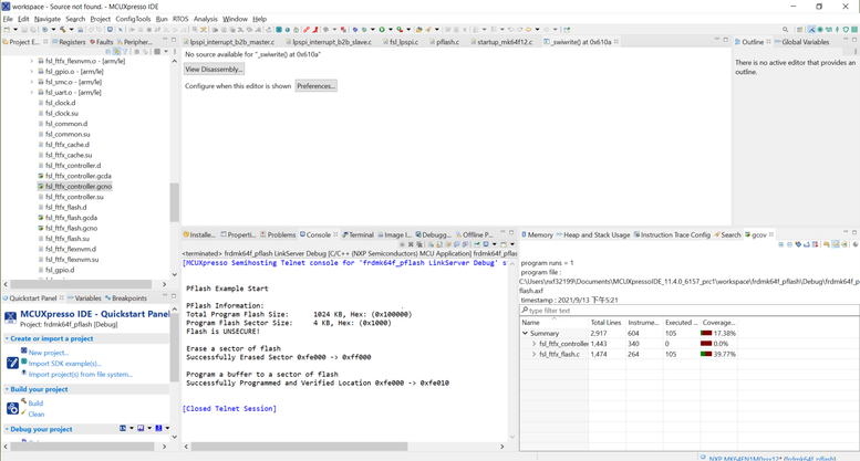

I have trying to generate the lcov and gcov report for ".c" files base on evkIMXRT1170 with "Hello World" example code.
I have followed the gcov generation step from MCUExpresso IDE -> Help -> MCUExpresso IDE user guide.
From that I have tried to generate gcov report but it's showing "gcov files not found".
Can you explain briefly the all steps with screenshot.

Hi @HCPATEL99 ,
I don't own the i.MX RT1170 board, but I checked it with the i.MX RT1064 board I have and wrote a tutorial about using it:
https://mcuoneclipse.com/2021/09/19/tutorial-gnu-gcov-coverage-with-the-nxp-i-mx-rt1064/
That one works for me.

Hi @HCPATEL99 ,
if  https://mcuoneclipse.com/2021/02/01/tutorial-gnu-coverage-with-mcuxpresso-ide/ does not help, check what has been generated in the 'debug' folder. The compiler shall generate .gcno files in there, and the application shall generate .gcda files. For the .gcda files you need to have a functional semihosting with file I/O supported, for example a SEGGER J-Link (that one can be loaded as firmware on the i.MX RT EVK board).

For me  https://mcuoneclipse.com/2021/02/01/tutorial-gnu-coverage-with-mcuxpresso-ide/ does not help.
After adding all the settings according to above link's steps I am able to generate the ".gcno" file at build the project stage also generated ".gcda" file at debug the project using the "J-Link Segger".
But, When I am trying to open the ".gcda" file there are not showing any results also no any pop or another chart window(graphical window).
Can you help me out for this below I have attached screenshot for my current settings for generating a ".gcda" report file for a single ".c" file.

I test your demo on my evk. I found that CMSIS-DAP can't read gcov data well. It will hang in gcov_write(). But jlink can. After finish, it can exit gcov_write(). You must wait nearly one minute till it finish download.
I'm win10. But I meet the same problem like you. I can't open .gcda. But I can open Erich's FRDM-K64F gcda.

Thanks for sharing the files. At a high level, the settings look ok. I can open the gcov files on my machine (Windows, not sure if this matters), of course I needed to point to the different file location.
But the files are empty in the sense that no useful coverage information is collected.
I don't have your hardware at hand, so I have to check things otherwise if time permits.

HCPATEL99
Hello @ErichStyger
Thanks a Million ErichS.
Finally It's working for me.
But, Still I want one little help about how to export this "gcov" code coverage data into ".html" or any other format like ".csv".
Please give me any hint or any link those are previously generated this type of report.
Also I have tried opening this data into ".csv" fomat but it's showing internal error(from eclipse given tools).

ErichStyger
Specialist I
The reason is because there is no code behind your assignments to status, so it cannot be covered. Not sure if I should go into the topics and depths of 'basic blocks' and 'brancht tail merging' compiler-writer-lingo.
In short, there is no assignment to that status variable at all generated by the compiler, caused by optimizations. You might get code there if you turn off optimizations, or if you mark the status variable as volatile.
The compiler sees that you assign status in both branches (or basic blocks) and immediately return that value. So the compiler can load that directly into the register and no storage is needed.
Keep in mind that with coverage information you always will have such kind of things, especially with compiler optimizations. If you really want to tweak this, you will have to tweak the source code which as for myself would not do for this.
