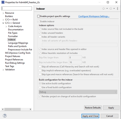

Hi @alannilsson
Could you please try to disable the project specific settings?
I checked the frdmk64f_freertos_i2c demo in my side, It can work after I uncheck 'Enable project specific settings'.

danielchen
Yes, when I import the frdmk64f_freertos_i2c demo into MCUXpresso IDE 11.2.1.  file tasks.c not indexing, and breakpoints not working.  the file size is quite large, 179K.   after I uncheck ' 'Enable project specific settings'',   'Index -> Refresh all Files' , rebuild,     indexing and breakpoints are working on my side.
If this issue still there, please refer to @ErichStyger 's  document:  Fixing the Eclipse Index.
