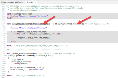

tasks.c: attached
freeRTOSConfig.h: attached
freertos_tasks_c_additions.h: exists

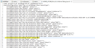

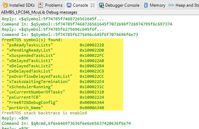

I believe there are some symbols missing (maybe due optimization or because you are using the NXP FreeRTOS port). I maintain my own port which covers all optimization levels and compiler settings, anyway.
I recommend you might have a look at yet another article of mine, more specific to this problem:
https://mcuoneclipse.com/2017/07/27/troubleshooting-tips-for-freertos-thread-aware-debugging-in-ecli...
It describes a debug level setting you can use for the LinkServer configuration. The latest IDE somehow has the GUI for it removed somehow, but you can edit the .launch and change the setting manually:

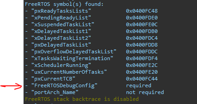

Then you should get a list of symbols found:

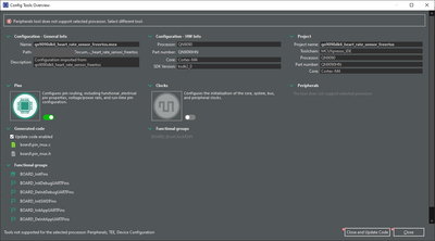

Looking the above, what do I need to update to make the peripherals supported since this is the example being provided? I am not sure if that is why the FreeRTOSDebugConfig does not have an address like your documentation shows.

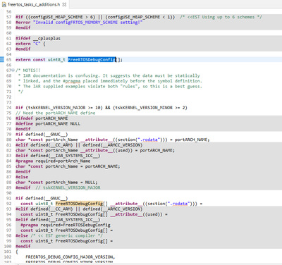

As for the FreeRTOSDebugConfig:
Check that it is indeed linked with your application (and not optimized away)
and just in case: I maintain my version here: https://github.com/ErichStyger/McuOnEclipseLibrary/blob/master/lib/FreeRTOS/Source/include/freertos_... which has been immunized against linker and compiler optimizations.
Keep in mind that for it there are two macros required:
Not sure, but I guess peripherals config tools is not implemented?
You might have to check this list:
https://community.nxp.com/t5/MCUXpresso-General-Knowledge/MCUXpresso-Supported-Devices-Table/ta-p/11...
But: It would be much better if you would open a different thread for each item.

peripherals config tools is not implemented, in the spreadsheet line 138 is the board. QN9090DK6 is the board, Cortex-M4 I would guess falls in there. If not I can create a new thread to continue and debug this issue.
