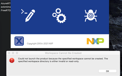

Dear support.
I am using MCUXpresso IDE 11.4.1,  with MAC os.
When I launch MCUXpresso IDE,   will fail. please refer to below picture for error message.
I have read & write privilege to my workspace.
I have tried to delete the lock file in workspace, it does not work.
If I create a new workspace it can work.
How can I solve this problem  Thank you .

Hello @davidzhu
Ok , so I understand that when you create  new workspace I works properly. So the workspace you are trying to use has a long location path this could be causing the problem also please make sure that the you don’t have any special character in your workspace or spacing.
