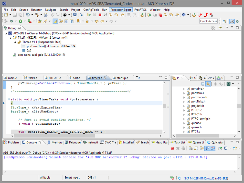

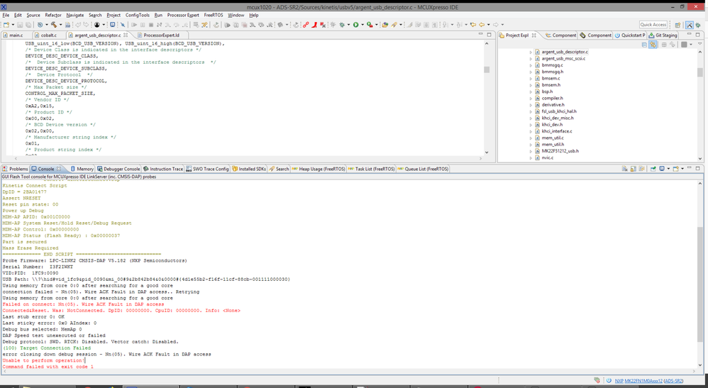

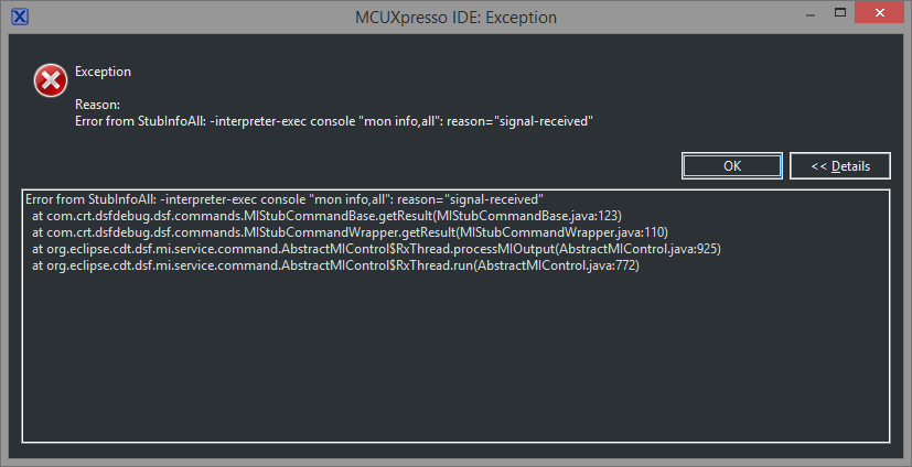

New developments - this keeps getting more frustrating.  When the system hangs, I'm able to start a new debug session in attach-only mode, and for just an instant I get the stack trace!
It took me a few attempts to get this screenshot.  But this means that the target is NOT completely dead, that it CAN be accessed by the debugger but something on the front end is broken.  If I could keep it running for 30 seconds, I could get what I need out of it.
It also gave me an error between attach attempts:

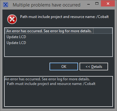

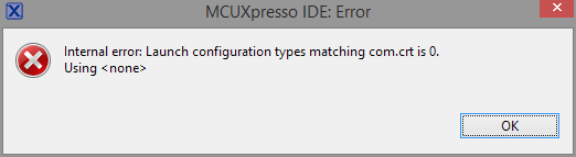

And before that, while attempting to create a new debug configuration, I got yet another error:
I have no idea what path it's referring to.  I had to duplicate an existing configuration.
Any ideas?

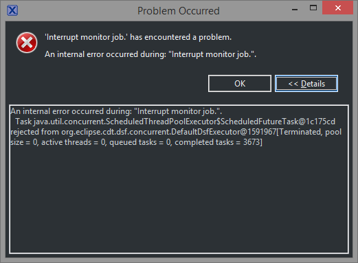

Got a couple more new errors while attaching and trying to catch the information I need:
I did manage to catch some useful information in a screenshot that's pointed me toward an ISR I need to check out.  This reminds me of the time we had to keep snapping pictures of the Netware server's screen with a Polaroid to catch the error message it showed for half a second on boot...
I'll work on getting my application working, but I'm going to keep posting MCUX errors here because I'd really like to get the system stable.

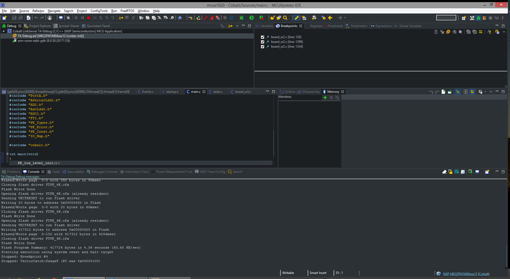

lpcxpresso_supp
So that screenshot suggests that your application has triggered a "usage fault" (one of : Undefined instruction, Attempt to enter an invalid instruction set state, Failed integrity check on exception return, Attempt to access a non-existing coprocessor, Illegal unaligned load or store, Stack overflow, Divide By 0).
You may be able to obtain more information about the trigger for the fault when debugging with LPC-Link2 using the IDE's "vectpc" functionality (described in section 11.6, "Registers" of the MCUXpresso IDE v10.2 User Manual).
The "vectpc" functionality doesn't work with P&E, but you could use something like the mechanism described on the mcuoneclipse blog instead : Debugging ARM Cortex-M Hard Faults with GDB Custom Command | MCU on Eclipse
For a more detailed explanation of usage faults, check ARM's Cortex-M documentation. In particular this Keil/ARM application note which gives a good overview: Application Note 209: Using Cortex-M3/M4/M7 Fault Exceptions

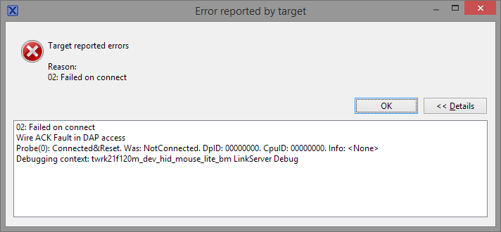

Posting here instead of starting over with a new thread because I'm still dealing with the original problem, or at least something similar.

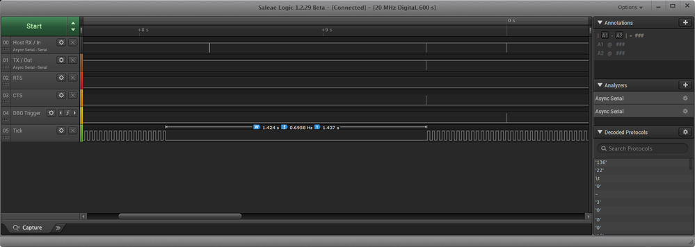

I'm debugging a board that's freezing after some interval.  It's not getting a watchdog reset so I think it's a task-level problem (it's a FreeRTOS project) but I'm not able to figure out where it's happening because the debugger silently loses its connection.
This is true with both the Cyclone ACP and the LPC-Link2.  The EWM is configured (it drives a hardware safety to prevent an attached device from overheating in the event of a lockup) and I've got a breakpoint set in the EWM/WDOG interrupt.  The breakpoint is never triggered.  When I see that the LED has stopped flashing and the board is locked up, I can hit 'pause' on the debugger but the connection is gone.
I've put a logic analyzer on the reset line and it's never asserted during the crash.  I just caught another one and I can see that the EWM line goes low about 250 ms after it stops, which is the expected behavior, but again the breakpoint didn't work - or wasn't shown by the debugger at least - and the connection was lost when I paused it.
The EWM interrupt triggers a message on the UART, and interestingly the message wasn't displayed until *after* I stopped the debugger.  This is entirely separate from the IDE - it's not semihosted, it's a dedicated UART on its own serial port.
That suggests to me that maybe the breakpoint *did* work but it just wasn't displayed in the IDE.
Can someone explain how this is possible?  Under what conditions can the debugger lose contact with the target board without a reset signal, and why would the loss of contact not be detected immediately?  More importantly, how can I maintain the connection so I can see where the fault is happening?

lpcxpresso_supp
Hi Scott,
Sorry for the continued problems. The "Wire ACK Fault in DAP access" is a result of an ACK error being reported by the DAPLink probe after an AP/DP register transaction. It's hard to speculate as to the cause/effect of the ACK. In this case, the debugger reports a wire fail using a system reset signal after the flash operation. In your project launch configuration, set VECTRESET as the Reset Handling method, and retry the connection. Report your results.

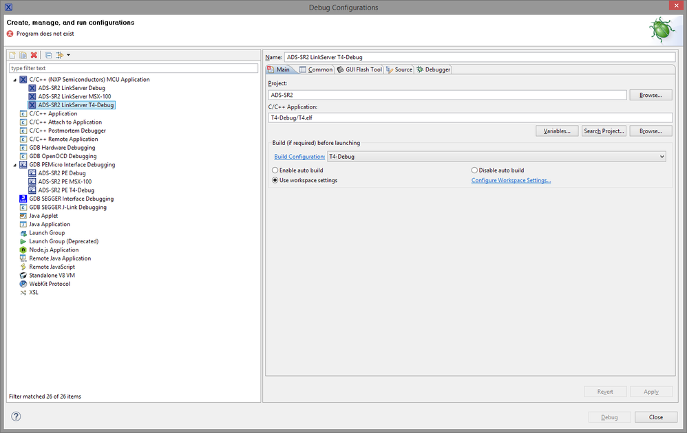

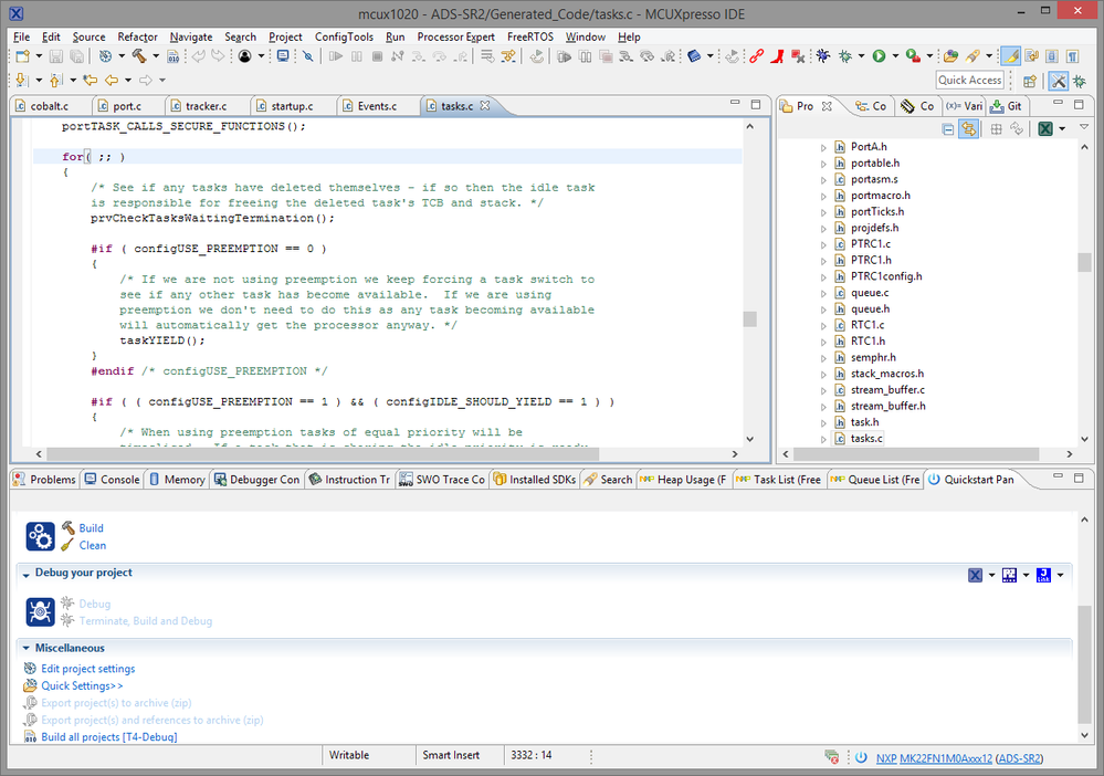

Continuing with my troubleshooting.  My main problems now are no task-aware debugging with the LPC-Link2, and I still can't launch debug configurations directly.
'Search Project' from the debug configuration has been weirdly inconsistent.  It'll simply not find binaries.  I can browse to them and they're in the right place but it won't find them otherwise.  I just rebuilt all of the configurations and now all three are showing up in the list again.
Of my P&E configs, now two are giving me an active debug button. And now that I switch back to the NXP configs, all three have debug buttons.  On P&E #3, copied the application location from NXP #3 but still no debug button.  'Search Project', selected the binary, no change.  Clicked back over to the NXP #3 config for reference, then back to P&E #3 - and now the debug button is active!  I changed nothing, just switched views.
Launched from the debug config screen and it worked normally.  Still no debug button in quickstart.  All configs still have an active debug button.  Selected NXP #3 and 'debug', got a new error:
Never seen this one before.  Target discovery is now stuck, won't cancel.  Cleanup doesn't help.  Closing the IDE and restarting.
Still no quickstart debug button.  All six debug configs are still active.  Launching with NXP #3.  Now I get the probe selection and I can choose All-Stop.  Suspend works, but still no task list in the debug view.  Incidentally, reset handling has reset to the default blank setting but I'm not getting a wire ACK error.

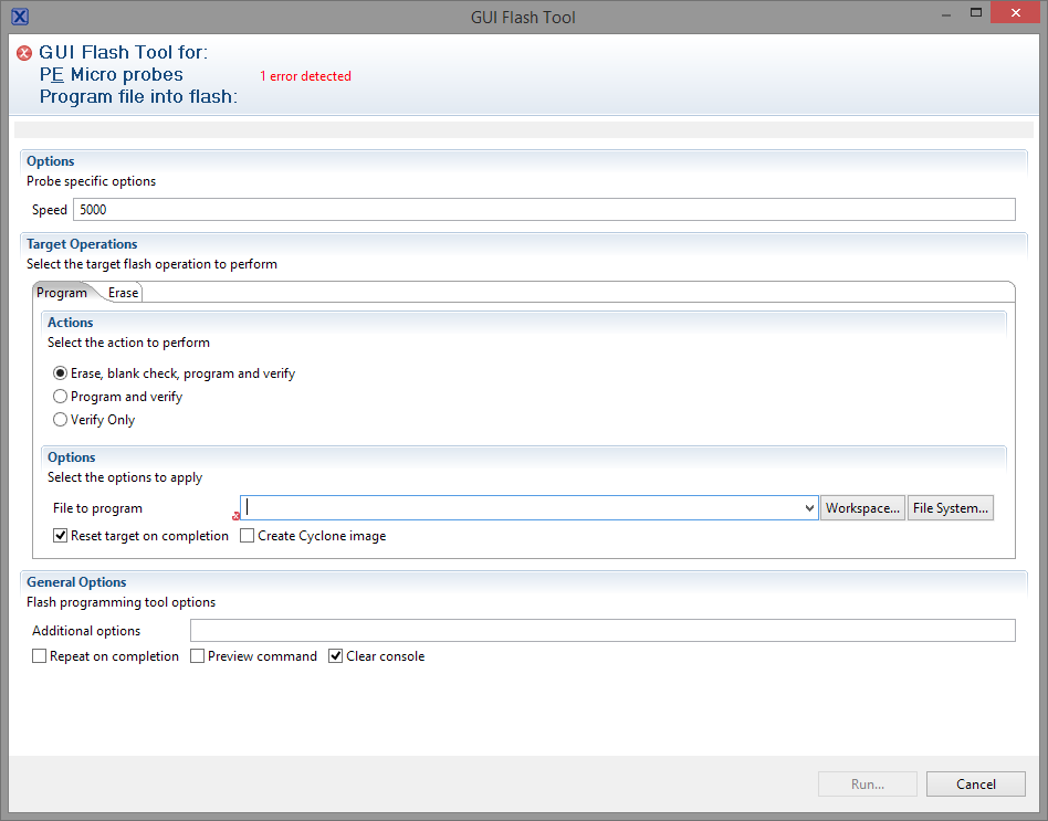

Clicked on the flash GUI tool to check something and got this:

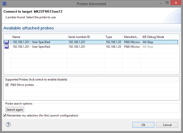

Cancelled, made sure redlink server was down, tried again.  Got the probe discovery screen this time.  Ran the mass erase and it worked.  I was trying to recreate something I meant to ask about previously - every time I'd try to run a mass erase, it'd pop up with the probe discovery screen again, but this time showing only one option.  I had that happen at least half a dozen times, and now it's not doing it.
Clicked on the blue bug.  Still getting an error:
Following Erich's instructions, I've set the debug level to 4 in the debug config.  FreeRTOSDebugConfig says it's missing.  My FreeRTOS settings don't match Erich's; changed them and rebuilt.  Ok, now we're getting a task list.  It's slow to come up compared to the Cyclone, but it's there.  Back to the Cyclone, still looks good there.
Clicked on the MCUX drop-down from the quickstart debug panel and got another error about no matching launch configs (this time with something other than using: none but I didn't catch it), but now the probe discovery comes up.  Launches OK.  Tried the drop-down again, captured the error this time:
Switched build configurations.  Tried all three, none show a debug button in quickstart.  Green button works, but oops.. launched an inactive configuration, not the current one.  Remembered I had WFI in idle disabled, re-enabled it.  Launched from debug config screen on NXP #1 config, got the probe screen, changed to all-stop.
Restarted the IDE.  Now the blue bug is disabled again, and the one in the quickstart panel is still inactive.  But if I click down to the quickstart panel and back up to a project file, NOW the blue bug is active.  Still gives me a 'disabled' error.

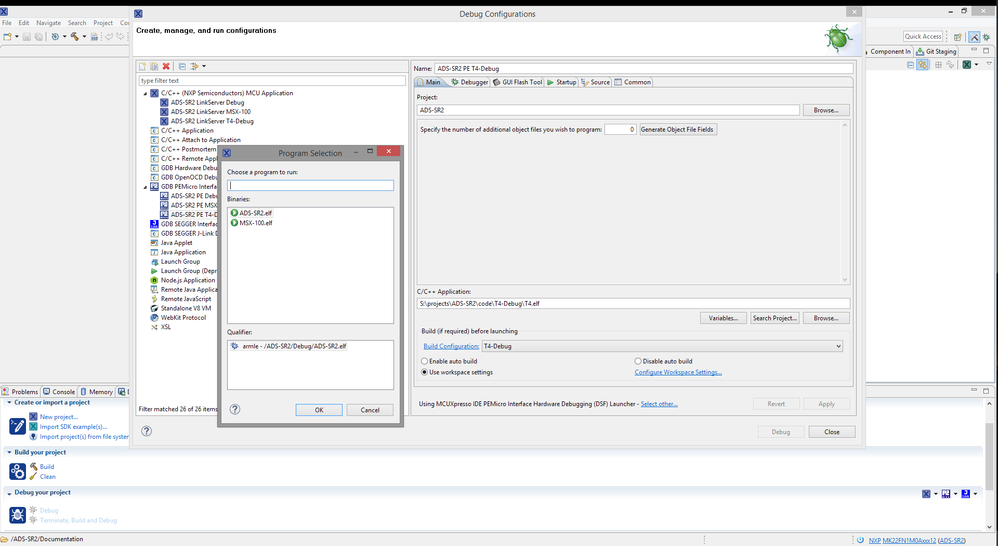

Back into debug config to set the log level back to 2.  Noticed semihosting on, which I don't want.  Turned it off - and now the debug button is disabled again!

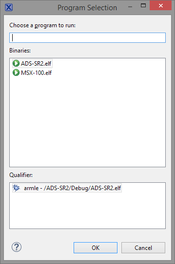

Switching back to the main tab, it now says the program does not exist:
Not in the program selection:
The matching config in the P&E group is also disabled.  Exited, rebuilt, no change.  Cleaned and rebuilt, still no debug button.  Pasted in the location of binary #1 into the location for NXP #3, 'Apply', no change.  Checked P&E #3, back to NXP #3, now the debug button is back.  Changed it back to the right binary, 'Apply', debug's disabled.
Clicked 'Browse', selected ELF binary.  'Apply'.  No debug.  Exit, rebuild - nothing to be done.  Search project, still no binary found for config #3.  Clean and rebuild, still no debug button.  Note that it doesn't say it's missing the binary.  Still nothing in 'search project'.  P&E config #3 has a location of "T4-Debug/T4.elf".  It does not show an error - but no debug button.  Pasted that into NXP config #3 and I immediately get "program does not exist."
Restart IDE, clean, rebuild, no change.  Changed the debug level and semihosting settings back just for the heck of it, no change.
Entering garbage for the application in P&E config #3 does not give a 'not found' error, so maybe it doesn't check?
Switched to build configuration #1 and rebuilt, and NOW all three binaries show up in "search project" again.  Select the binary - no debug button.  Look at another config, then back, now it's active.
To confirm that the build configurations are correct:  Build artifacts are "ADS-SR2" for #1, "MSX-100" for #2, "T4" for #3.  This is correct. It was T4-Debug/T4.elf that wasn't showing up in the list.  Rebuilding Debug/ADS-SR2.elf made T4-Debug/T4.elf show up in the list.  Still no quickstart blue bug.
Trying to replicate the debug button getting disabled.  Active build config is #1. Set semihosting off, apply - debug is disabled for an instant but comes back.  Switched to build config #3.  Noticed that the debugger tab is in a different place in each debug config, and it moves at random when I switch between configs.  My Android developer happens to be passing through at this moment and says "that's because it's Eclipse."
Set semihosting back on, loglevel to 4, debug launches normally.  Set everything back, no change.  Tried the blue bug again - same error.  Switch to P&E config #3 and debug, works normally.  Clean project so now binary #3 is in fact missing.  T4.elf still shows up in "search project", though a file system search shows it's not really there.  There's no warning about a missing application.  Click debug, project builds and launches normally.
I think that's about all I have in me for tonight.  To recap: I'm now able to debug with the LPC-Link2.  The reset handling option is NOT set.  In fact, I just changed it to 'default' and it works the same; I have no idea what actually made the difference.  Disabling non-stop debugging and setting the FreeRTOS debug config properly got the suspend function working.  The quickstart menu still doesn't give me a debug option, and the blue bug on the toolbar throws an error.  The debug button from the debug config seems to stop working randomly and starts working again when a different config is rebuilt.
I hope that's enough to go on, and to illustrate the inconsistent behavior I'm seeing.  I was going to edit this down but seeing as I haven't come to a useful conclusion on some of these issues I'm going to leave my whole rain dance of a troubleshooting session intact for reference.

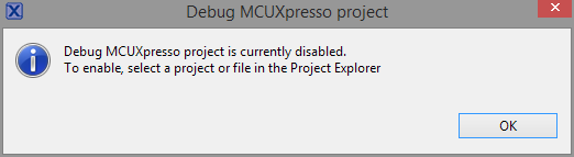

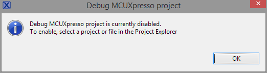

And the blue bug on the toolbar doesn't work:
Nor does the launch shortcut dropdown from the quickstart menu:
But my deleted configurations came back.  Deleted them again.  Blue bug again, same error, no configurations created.  Clicked on the dropdown again, same error, but the configurations are back.

For reference, here's the output from the mass erase command when the device is secure.  The 'part is secure' and 'mass erase required' messages are in a subdued color, while the ACK fault is highlighted in red.  'Mass erase required' is also rather misleading as an error message, because the operation requested is a mass erase.  And at least for the HCS08 and ColdFire families, a mass erase is how you clear protection.
The user specifically requests a mass erase (in the target operations panel), the system appears to confirm that a mass erase is required, and then it dies with an apparently unrelated wire ACK fault message.  This has to be one of my (ahem) 'favorite' things about working in the embedded world - the error message that keeps coming up for me, when trying to do the simplest things, is something that Google shows only 5 hits for.  I read all 5 pages, and the only one that seems at all relevant says that the problem was fixed by running the mass erase script.
Does anyone know what 'Wire ACK Fault in DAP access' actually means?  And what the heck is so special about my setup that I get error messages virtually no one else has ever reported?  My setup is a bit non-standard but not outrageously so.  I'm running a fresh install of MCUX 10.2.0 on Windows 8.1 Enterprise, with the GNU ARM toolchain (which I believe is standard for MCUX now) and Processor Expert.  The other peripherals on the machine are about what you'd expect for any embedded systems developer - logic analyzers, oscilloscope, function generator, DC load, sometimes other debug probes and burners.  The more exotic items (communications test set, CNC milling machines) are on RS-232 and wouldn't affect anything.

Here's what I get when attempting to run the mass erase using the LPC-Link2:
Executing flash operation 'Erase' (Erase flash) - Thu May 24 10:27:54 PDT 2018
Checking MCU info...
Scanning for targets...
Executing flash action...
MCUXpresso IDE RedlinkMulti Driver v10.2 (May 10 2018 18:10:59 - crt_emu_cm_redlink.exe build 510)
( 0) Reading remote configuration
Wc(03). No cache support.
( 5) Remote configuration complete
Reconnected to existing link server
Connecting to probe 1 core 0:0 (using server started externally) gave 'OK'
============= SCRIPT: kinetisconnect.scp =============
Kinetis Connect Script
DpID = 2BA01477
Assert NRESET
Reset pin state: 00
Power up Debug
MDM-AP APID: 0x001C0000
MDM-AP System Reset/Hold Reset/Debug Request
MDM-AP Control: 0x00000000
MDM-AP Status (Flash Ready) : 0x00000036
Part is secured
Mass Erase Required
============= END SCRIPT =============================
Probe Firmware: LPC-LINK2 CMSIS-DAP V5.182 (NXP Semiconductors)
Serial Number: I3F2IWKT
VID:PID: 1FC9:0090
USB Path: \\?\hid#vid_1fc9&pid_0090&mi_00#9&2b842b84&0&0000#{4d1e55b2-f16f-11cf-88cb-001111000030}
Using memory from core 0:0 after searching for a good core
connection failed - Nn(05). Wire ACK Fault in DAP access.. Retrying
Failed on connect: Nn(05). Wire ACK Fault in DAP access
Connected&Reset. Was: NotConnected. DpID: 00000000. CpuID: 00000000. Info: <None>
Last stub error 0: OK
Last sticky error: 0x0 AIndex: 0
Debug bus selected: MemAp 0
DAP Speed test unexecuted or failed
Debug protocol: SWD. RTCK: Disabled. Vector catch: Enabled.
(100) Target Connection Failed
error closing down debug session - Nn(05). Wire ACK Fault in DAP access
Unable to perform operation!
Command failed with exit code 1
I switched to the Cyclone and ran a mass erase from PROGACMP and after that a mass erase from the GUI tool with the LPC-Link2 succeeded.  I launched a debug session and again got the wire ACK fault.  After that a mass erase with the GUI took again fails in the same way as before.  When I launch from the Cyclone, the device is NOT protected - not in the debug build, anyway.  Normally I only set the flash protection bits after the fact in my deployment packaging script.
Scott

I'd tried a mass erase several times, both with the GUI tool and with the standalone PROGACMP utility from P&E.  Let me see if I can cover all of the things I went through this morning.
I started a new workspace and built the FRDM-K22F LED flashing demo project and successfully ran it with the LPC-Link2.  I switched back to my regular workspace and confirmed that it worked there, too.  In the new workspace I switched to the TWR-K21F120M and another SDK demo.  Using the LPC-Link2 it failed with a 'Wire ACK Fault'.
At some point I was able to get a TWR demo to run with the Cyclone, but at least one time it gave me the same symptoms on the TWR board as I was seeing yesterday, namely the debugger losing its connection.
I switched back to my own project and found that I had no debug options at all - nothing could be launched.  The GUI flash tool wouldn't let me choose an image:
All of the launch options were disabled:
Cleaning the project did nothing. I closed the IDE, deleted the output folders for all build configurations, restarted, and tried to rebuild.  The T4-Debug configuration said it was missing a makefile.  I switched to another configuration and built successfully, then was able to switch back to T4-Debug and rebuild.  Then it all started working again - the board that was consistently giving me debug failures last night works fine now.  I'm still not able to click the 'debug' button from the debug configurations dialog, though.  And it created a duplicate debug configuration for T4-Debug that wiped out my settings for supply voltage and such.
