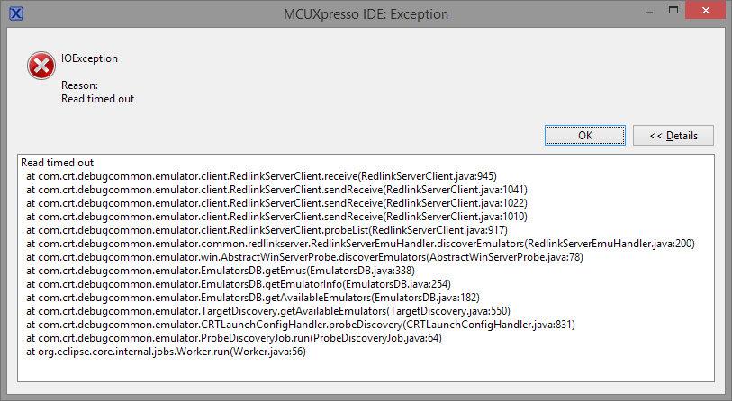

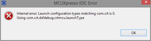

New developments - this keeps getting more frustrating.  When the system hangs, I'm able to start a new debug session in attach-only mode, and for just an instant I get the stack trace!
It took me a few attempts to get this screenshot.  But this means that the target is NOT completely dead, that it CAN be accessed by the debugger but something on the front end is broken.  If I could keep it running for 30 seconds, I could get what I need out of it.
It also gave me an error between attach attempts:
And before that, while attempting to create a new debug configuration, I got yet another error:
I have no idea what path it's referring to.  I had to duplicate an existing configuration.
Any ideas?

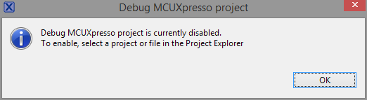

Continuing with my troubleshooting.  My main problems now are no task-aware debugging with the LPC-Link2, and I still can't launch debug configurations directly.
'Search Project' from the debug configuration has been weirdly inconsistent.  It'll simply not find binaries.  I can browse to them and they're in the right place but it won't find them otherwise.  I just rebuilt all of the configurations and now all three are showing up in the list again.
Of my P&E configs, now two are giving me an active debug button. And now that I switch back to the NXP configs, all three have debug buttons.  On P&E #3, copied the application location from NXP #3 but still no debug button.  'Search Project', selected the binary, no change.  Clicked back over to the NXP #3 config for reference, then back to P&E #3 - and now the debug button is active!  I changed nothing, just switched views.
Launched from the debug config screen and it worked normally.  Still no debug button in quickstart.  All configs still have an active debug button.  Selected NXP #3 and 'debug', got a new error:

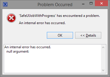

Never seen this one before.  Target discovery is now stuck, won't cancel.  Cleanup doesn't help.  Closing the IDE and restarting.
Still no quickstart debug button.  All six debug configs are still active.  Launching with NXP #3.  Now I get the probe selection and I can choose All-Stop.  Suspend works, but still no task list in the debug view.  Incidentally, reset handling has reset to the default blank setting but I'm not getting a wire ACK error.
Clicked on the flash GUI tool to check something and got this:
Cancelled, made sure redlink server was down, tried again.  Got the probe discovery screen this time.  Ran the mass erase and it worked.  I was trying to recreate something I meant to ask about previously - every time I'd try to run a mass erase, it'd pop up with the probe discovery screen again, but this time showing only one option.  I had that happen at least half a dozen times, and now it's not doing it.
Clicked on the blue bug.  Still getting an error:

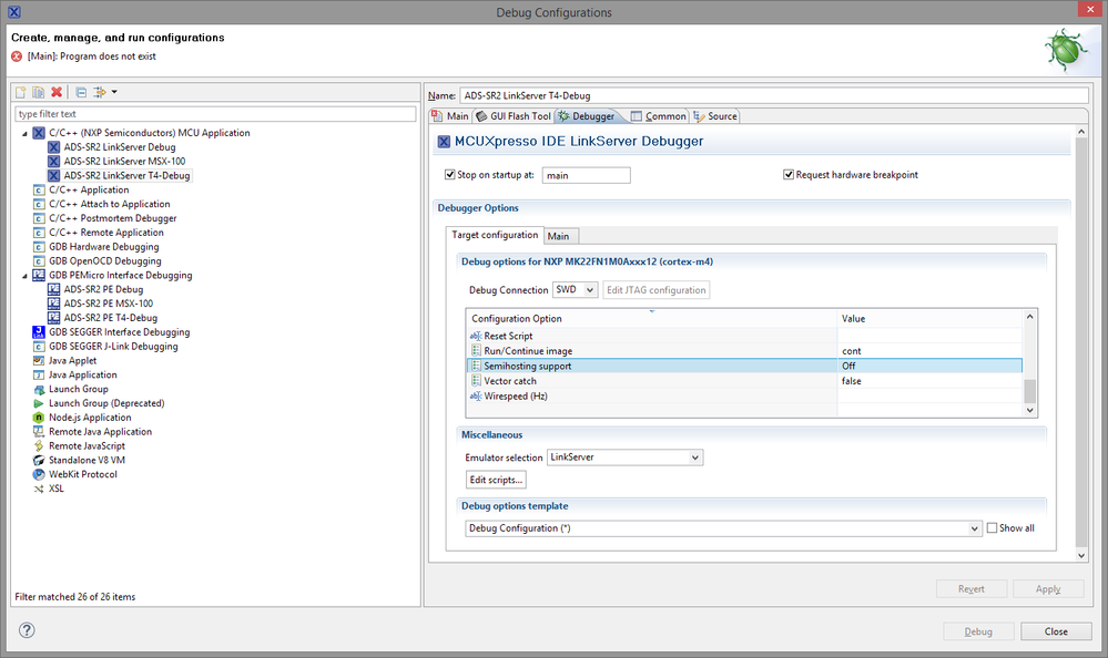

Back into debug config to set the log level back to 2.  Noticed semihosting on, which I don't want.  Turned it off - and now the debug button is disabled again!
Switching back to the main tab, it now says the program does not exist:
Not in the program selection:
The matching config in the P&E group is also disabled.  Exited, rebuilt, no change.  Cleaned and rebuilt, still no debug button.  Pasted in the location of binary #1 into the location for NXP #3, 'Apply', no change.  Checked P&E #3, back to NXP #3, now the debug button is back.  Changed it back to the right binary, 'Apply', debug's disabled.
Clicked 'Browse', selected ELF binary.  'Apply'.  No debug.  Exit, rebuild - nothing to be done.  Search project, still no binary found for config #3.  Clean and rebuild, still no debug button.  Note that it doesn't say it's missing the binary.  Still nothing in 'search project'.  P&E config #3 has a location of "T4-Debug/T4.elf".  It does not show an error - but no debug button.  Pasted that into NXP config #3 and I immediately get "program does not exist."
Restart IDE, clean, rebuild, no change.  Changed the debug level and semihosting settings back just for the heck of it, no change.
Entering garbage for the application in P&E config #3 does not give a 'not found' error, so maybe it doesn't check?
Switched to build configuration #1 and rebuilt, and NOW all three binaries show up in "search project" again.  Select the binary - no debug button.  Look at another config, then back, now it's active.

I switched back to my own project and found that I had no debug options at all - nothing could be launched.  The GUI flash tool wouldn't let me choose an image:
All of the launch options were disabled:
Cleaning the project did nothing. I closed the IDE, deleted the output folders for all build configurations, restarted, and tried to rebuild.  The T4-Debug configuration said it was missing a makefile.  I switched to another configuration and built successfully, then was able to switch back to T4-Debug and rebuild.  Then it all started working again - the board that was consistently giving me debug failures last night works fine now.  I'm still not able to click the 'debug' button from the debug configurations dialog, though.  And it created a duplicate debug configuration for T4-Debug that wiped out my settings for supply voltage and such.
