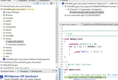

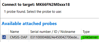

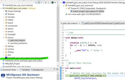

Hello, let me show you something, when you have a project without a debug launcher seems like this.
When a debug session is started, a popup window appears with all sondes available.
In this case the board has a J-Link firmware.
If I change for an external debugger or debugger firmware, I need to remove de launcher in order to the IDE stared again the Probe Discovery.
I change the OpenSDA from J-Link to LinkServer, but I need to delete the launcher to change the interface between the IDE and debugger.
Let me know if you have more questions.
