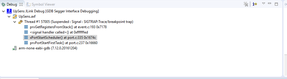

Hello i have the MCUXpresso 10.0.2 and i have to trace the function that generate the hard fault but using my segger j-link i can see only the last 4 functions called:
how i can increase the tree for see the function at lower level?

Your stack trace might not necessarily show the truth, as the hard fault could be caused by some stack corruption too.
It seems that your hard fault was caused during a context switch in FreeRTOS.
I would set a breakpoint in xPortStartScheduler() and step through the code to see what is happening. It could be that your stack runs into FLASH/ROM code?
If you want to see if other theads/tasks are running, have a  read at Troubleshooting Tips for FreeRTOS Thread Aware Debugging in Eclipse | MCU on Eclipse  which provides some checkpoints.
As for the hardfault itself, you could install a custom handler which reports you the last PC/access point (see that interrrupt handler at the end of Debugging Hard Faults on ARM Cortex-M | MCU on Eclipse ).

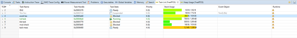

ypkdani
i have already tryed but the Thread Aware crash when i stop the debugger with this error, it say Ignoring Packet Error, continue...
I have update the segger driver but nothing.
I can debug without the Thread Aware enable but i can only see this
