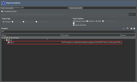

unfortunately, the RTC only provides a second timer, as mentioned the chapter 29.2.1 called features in the RM, however you can use the periodic interrupt timer (PIT) to make it.
The SDK (version 24.12) offers an example of this peripheral that could be helpful:
About the PIT code, you can change the PIT frequency with the function called "PIT_SetTimerPeriod". Also, I highly recommend see the Readme of the example to know how it works.

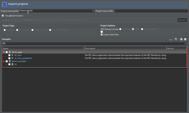

Hello @Transidico,
The SDK (version 24.12) provides some examples with the propose of show the RTC functionality, as shown the next image:

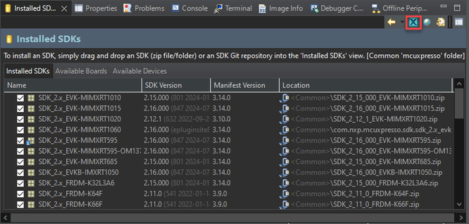

At the same time, you can download the SDK inside MCUxpresso IDE clicking the next button:
Inside to the window called "Download and install SDK" you can search the MCXC242 in the filter, where it will be showing the available SDK, as shown in the next image:
